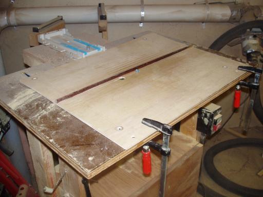

I make and sell Pool Cue and Gun cases. I use a lot of box joints. The best, cheapest and easiest way I've found is this simple jig on a router table.

dylder said:
...The best, cheapest and easiest way I've found is this simple jig on a router table.

I'm such a woodworking newbie that I can't quite tell what is going on with the jig. Is it a board that has been dado grooved multiple times at a certain interval equivalent to the finger width?
How do you square the piece for the first cut and what is that dark strip? Some sort of miter gauge groove?

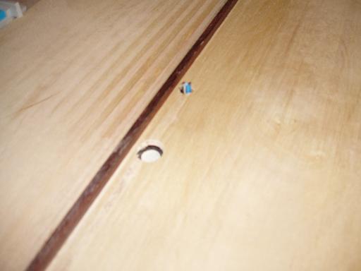

Its just a flat piece of plywood with a hole in it for the bit. The dark strip / guide is a 1/4" strip of wood - dado'd into the plywood and stands about 1/4" proud of it. You simply clamp the plywood on the router table so the bit is exactly 1/4" from the guide (I use a 1/4" drill bit as the gage). Hold your work against the guide wood, push it through = 1st cut. Place that cut in the guide, push it through = 2nd, 3rd .... For the dark strip/guide I use cocobolo because its hard and has natural oils.
I clamp several pieces together and sacrifice a scrap on the outside for chipout.
Sorry about the photos, where it looks like the plywood is grooved, thats just sawdust from making joints.
