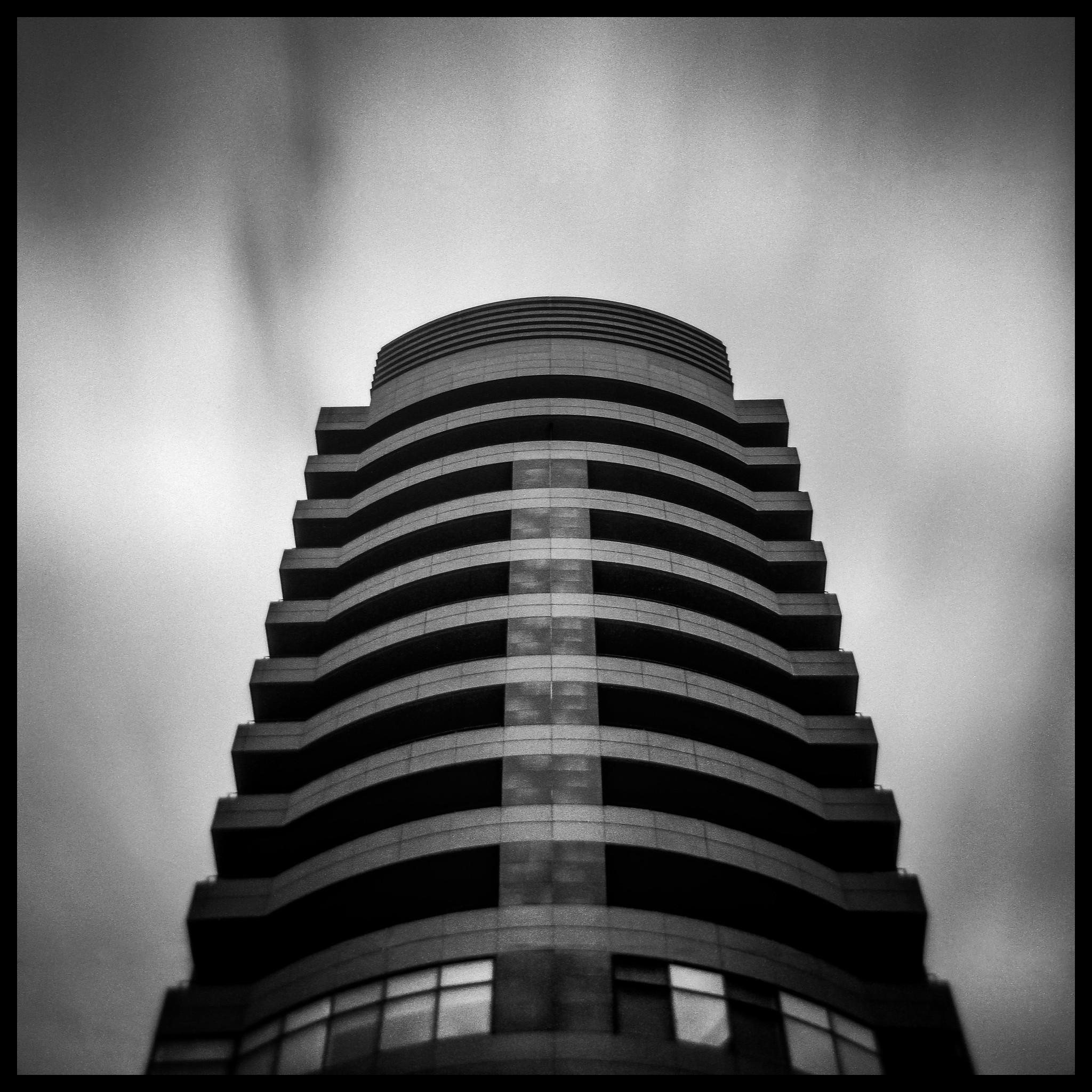

Below is a 4 minute long exposure on a Holga and Ilford Delta 100.
