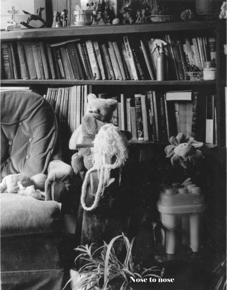

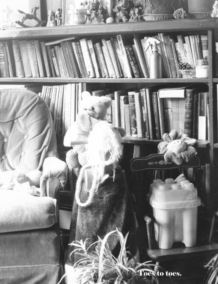

    I decided to illustrate my bawdy joke. These two prints were made to show what happens when I use the same printing contrast, same negative, but printing one for the highs and thr other for the lows. Development of the negative was with 10X borax timed as for ordinary D-76.

    That might have happened were it not for the lower initial and therefore lower average pH.

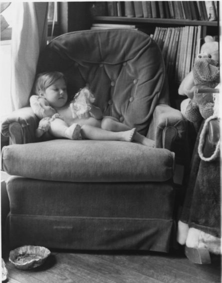

    I tried it last night and I think I'm going to like it after I learn it. 8 minutes @ 65 F gave higher contrast than I usually look for, but a simple change of paper grade was all it needed
  22. OP
    gainer
    gainer Subscriber
    Messages:
    3,725
    Joined:
    Sep 20, 2002
    That should have been 68 F. Here is a scan of the print to show gradations. That is my 2 1/2 year old great grand daughter, Daisy. She saw me setting up and insisted I take her picture.
