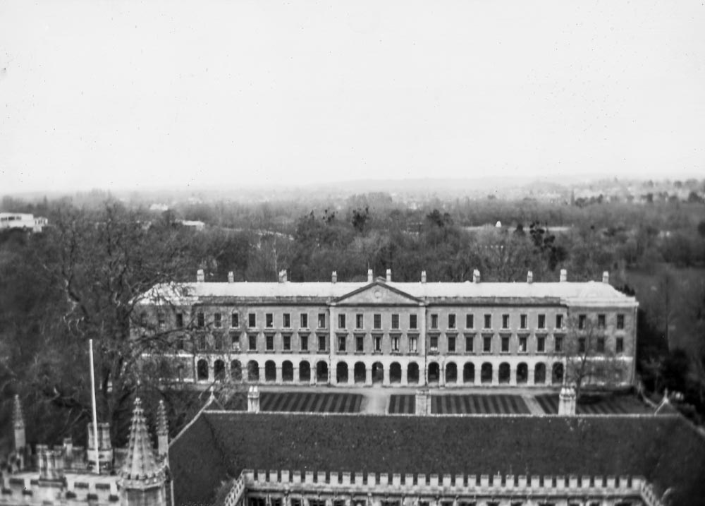

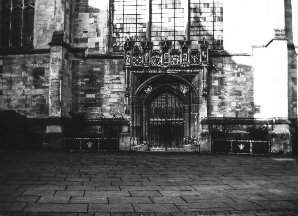

    Well, I've finally managed to run a few experiments with the Hawkeye, following the advice kindly provided in this thread, and using card-sized cutouts from an old batch of photo paper instead of glass plates. The results aren't bad - the lens (which I discovered is sadly not brass-mounted when opening the camera to clean it) has a distinct 19th century flavour. Exposure is for approximately 1.5 seconds or less in EV 12-13 (for ISO 100) conditions, tricky hand-held as in the second example (the first is supported on a parapet). I'll continue to play with this rewarding camera.

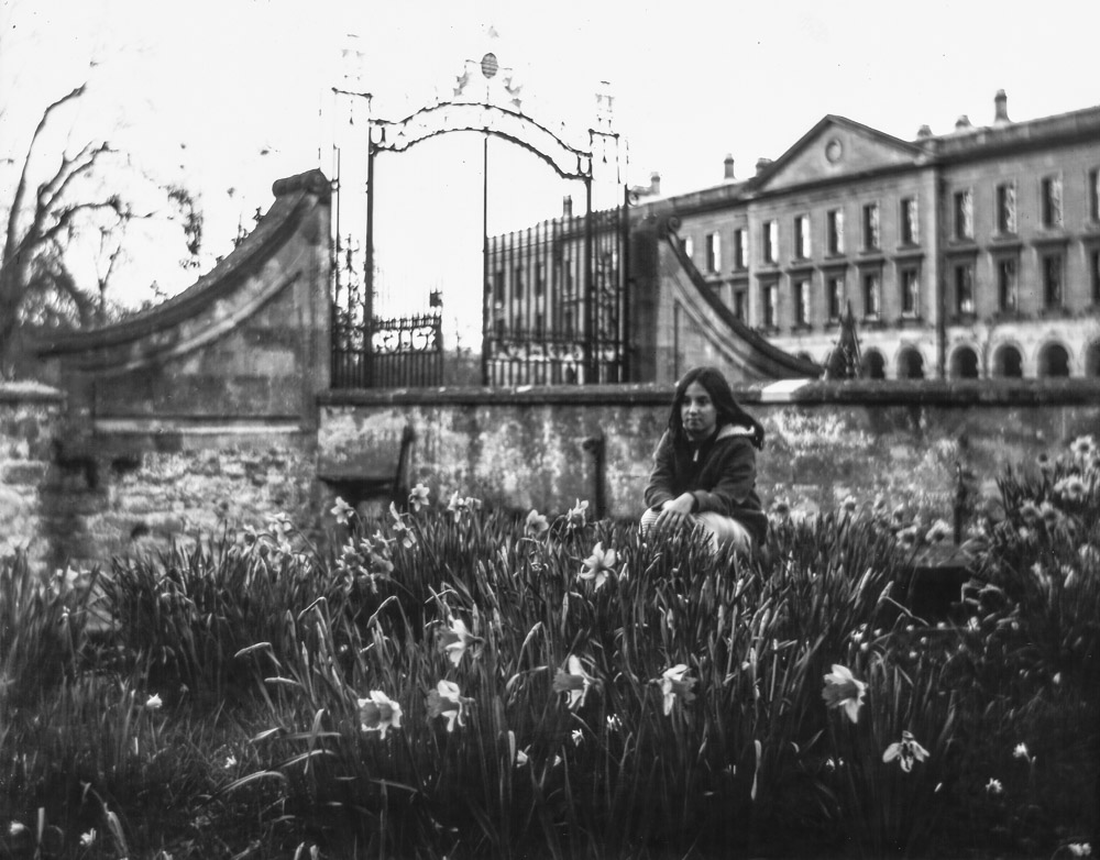

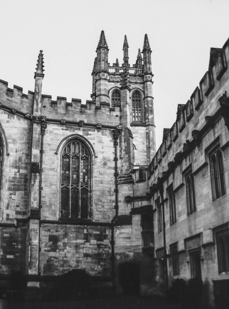

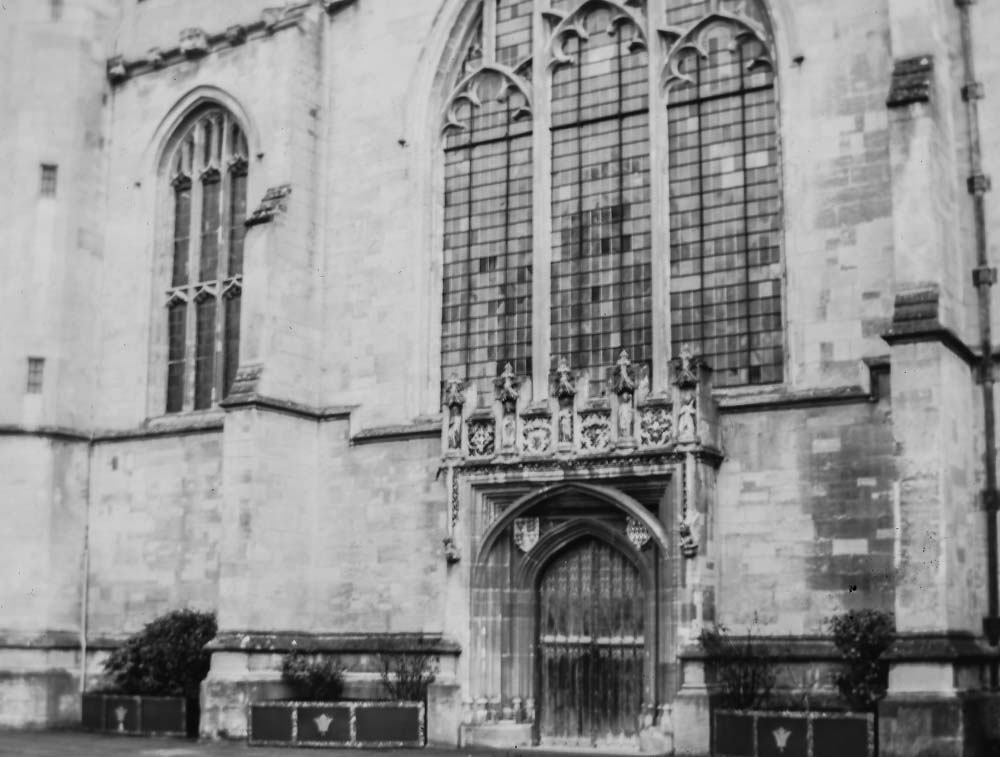

    Thank you very much for all your help, John. My method is getting better day by day - these are from yesterday, this time using a projector stand to steady the camera. The out-of-focus rendering is impressively harsh, almost the impression of heat rising from boiling tarmac. The detail in the centre is actually quite good, though the mediocre flatbed scanner does it little justice - 'scanning' using my digital camera would probably yield much more, though that one is ironically back in Germany for the second time in as many years for rangefinder re-calibration! I have been wondering about the focal length of this lens - the angle seems quite wide to me, and the (fixed) aperture something in the region of f/32 and /22 judging from the time needed to expose and assuming my paper is about ISO 6, but the depth of field quite narrow...
