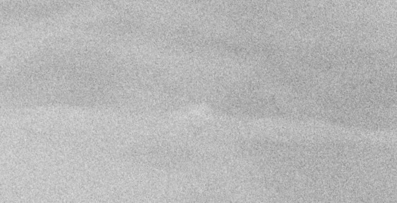

What do you call this type of grain from Black/White & Green on Tri-X? "Sandy"?
The grain on Tri-X from HC-110 1+31 looks better.
What do you think? I try alternatives but I keep coming back to HC-110.
Black/White & Green is not a very popular developer, and I wanted to like it. Maybe it should be used for larger formats.

HC-110 is very versatile and I use it frequently. But I also like D-23 for Tri-X and I don't think I have seen that type of grain before from any of the developers I have used with Tri-X. Tri-X usually works with just about anything. What was your development time?

1+49 15 minutes. 2 minutes over what they recommend, but still. I was seeing a pretty harsh grain in other's photos too.

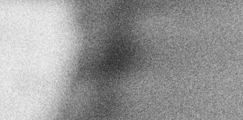

For example this is someone else doing it at the recommended 13 minutes.

I did a video about a year ago, comparing BW&Green with PC-TEA. They both contain the same ingredients, so I was thinking that the Green stuff was just PC-TEA. They rendered tones the same but BW&Green was much grainier than PC-TEA, with slightly better acutance.
