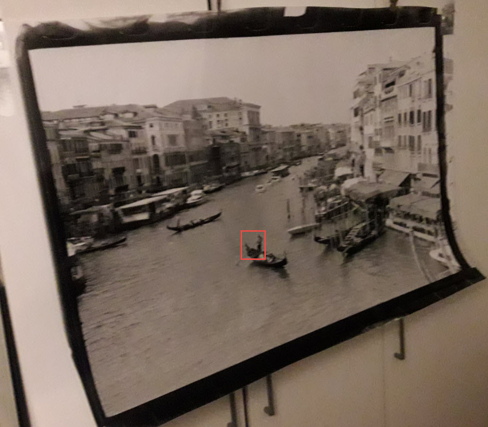

My wife wanted to have one big print in our living room, and last weekend I just made my first print bigger than 50x60cm.
I have roll of Fomaspeed that is 1,08 meter wide and 10 meters long, so for start my print is around 65x95 cm. Later I will try 1x1,5 meter.

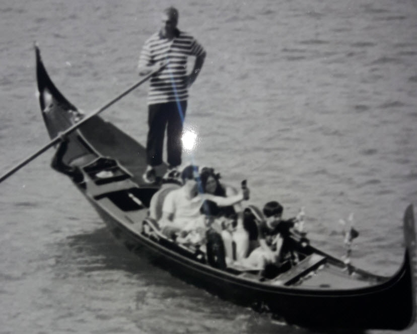

Shoot was taken with old Elmar 5cm f3,5 - but is shows small amount of grain nevertheless, even in close inspection (Kodak TP :smile: ).
Developer and fixer I did with a sponge, since I don't have so big trays.
Anybody has better idea in a lack of big trays?

Nice result, congratulations!
I am interested in the process because I am in a similar situation: my wife asking for bigger prints! I usually print up to 16x12 using 20x16 trays. So technically I can print up to 20x16. However I would like to try 20x24 or larger...but I am not sure about the process. It seems you got a pretty homogeneous development with a sponge, did you use very diluted developer? Can you please give me some details about the process? Why do you want to change?

Large prints from a certain size onwards are better not processed in trays of the print format, but in trays fitting the size of the print rolled over its short side.
Processing in such tray could be done by hand but there is also was on offer a dedicated roller insert.
Such trays could be improvised by using gutter profiles.

I developed in normal concentration: 1+9 in Ilford PQ developer, and 1+9 for the fixer. And in one print one liter is gone, pretty expensive, and since all is done on the floor (in my darkroom) - floor was dirty, and I needed to make is clean (ugly and time consuming).
That is why I am looking for alternatives.

The bathtub would need more bath volume than a long tray for rolled processing, it though could be used for sponge processing. But baths would go down the drain.

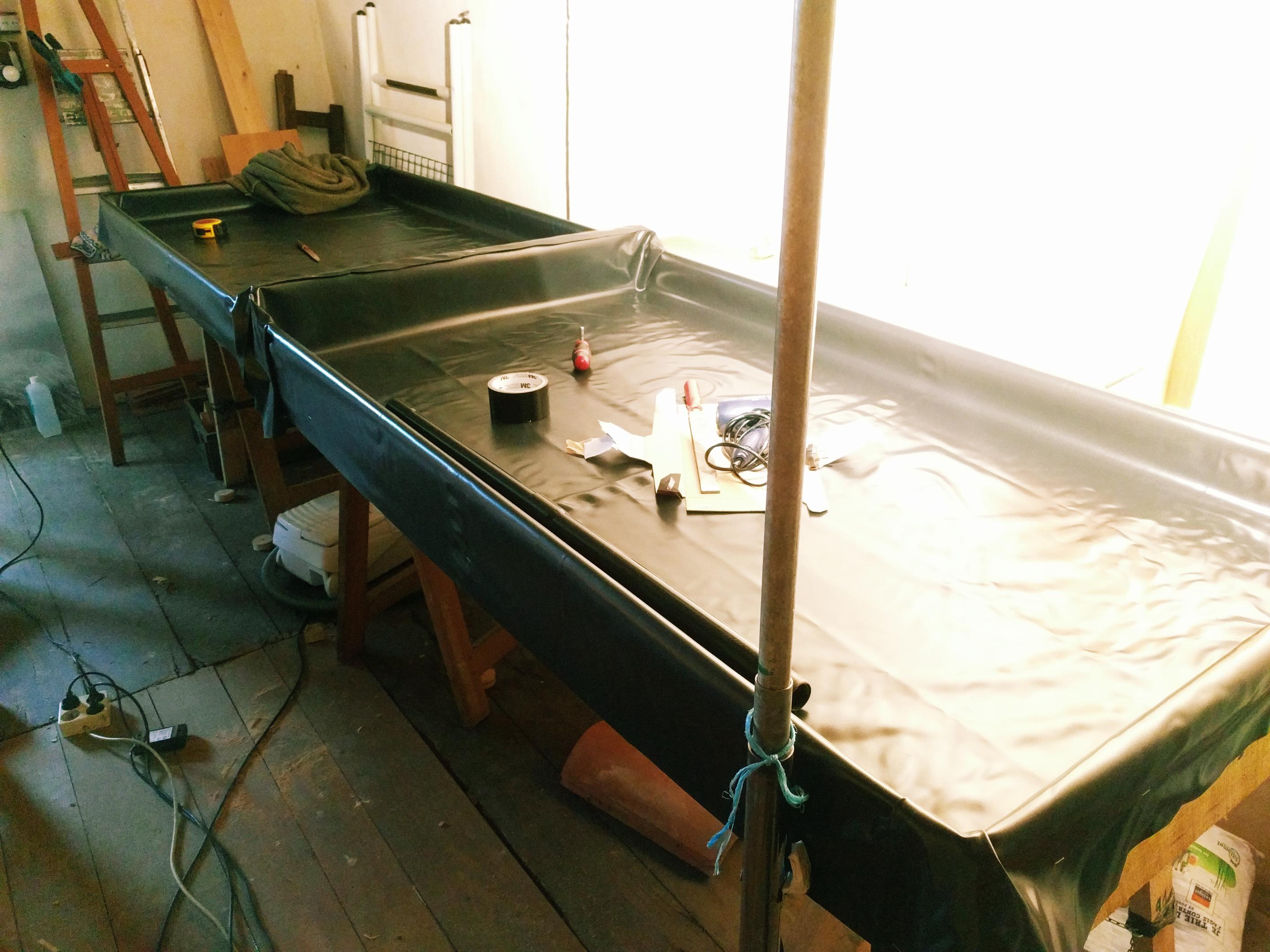

build your tray working tables. i tried a lot, and it can be done, depends on your skill. but it gets so much better when you make the space to do it right.
Wow, jealous :smile:! You have a lot of space, my darkroom is 8 sq meters only.
in this case you can build one single tray. and attach a pipe underneath. put paper in, flush with dev, drain to container underneath/bucket, close pipe, stop, flush, fix, etc. works great, using a few "buckets" under a tray and a pipe to open/close..

Never seen such. At least as far as I know here we use a sticky paste or so. I shall have a look for such. Anyway your processing tube depends on a decent sealing. At least enough to use it in a bath tub.
Any kind of gutter tray also will induce some spilling. Thus the ground should be covered with thick pvc foil with rims, so that one easily can wipe it.

I like the print. The idea of a traditional print from film shot with a vintage lens of a subject taking a selfie with a cellphone appeals to me. Don't tell anyone, see who notices.
