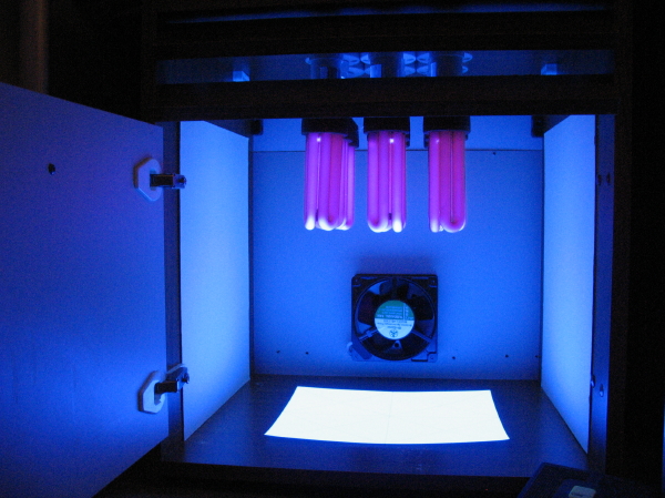

When making VC gelatine silver contact prints I use my Multigrade enlarger head as the light source. Ideal for split-grade printing.
For Pt/Pd printing I use ECF BLB (black light blue) 9 x 25 watts. This is a pic of my homemade UV light box.
