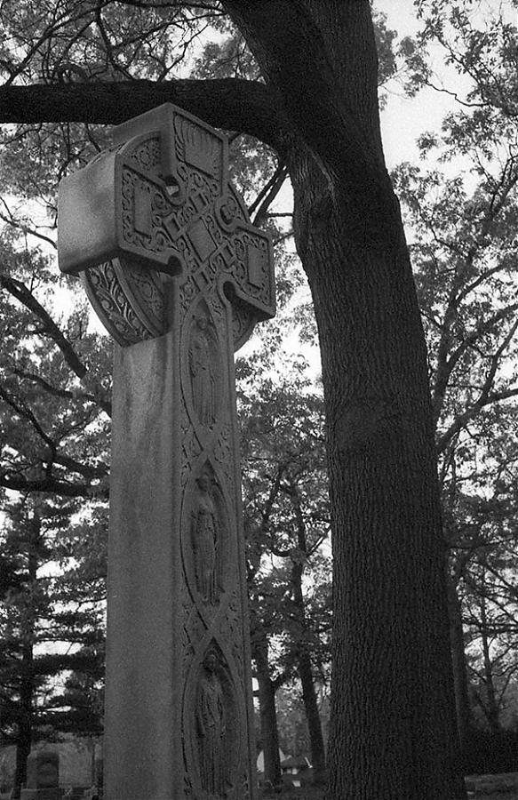

I seem to get desirable results developing in HC-110 for about 14 minutes, shot at 3200. Two images from such combination.
