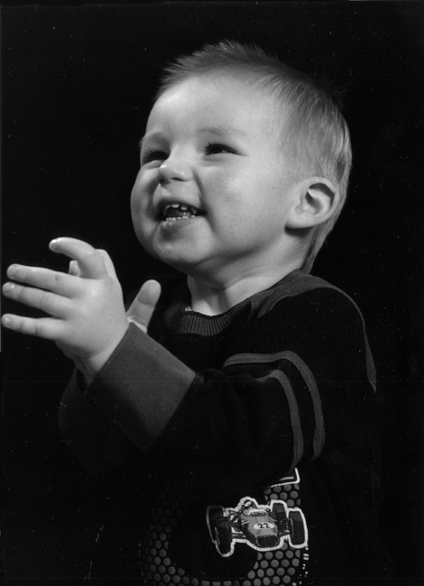

My vote is Delta 100 @ ISO 100. Developed in Rodinal for 13:30 @ 20C.
See attached photo for a shot from my studio with two strobes.
