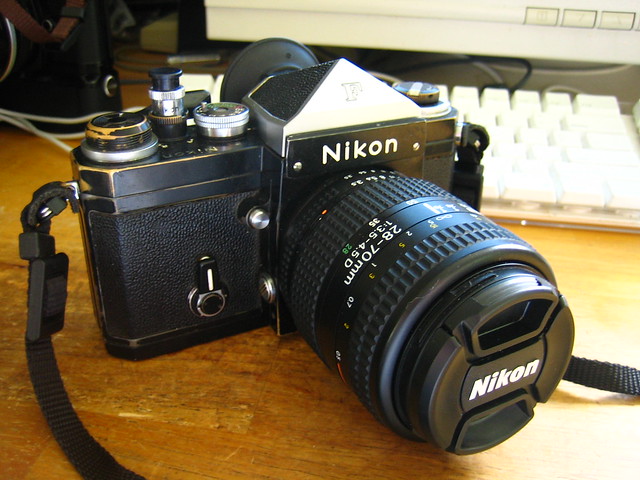

  14. John_Nikon_F
    John_Nikon_F Member
    Messages:
    1,960
    Joined:
    Apr 18, 2008
    Location:
    Duvall, WA,
    Shooter:
    Had no qualms using the little 28-70/3.5-4.5 on my old F eyelevel...
