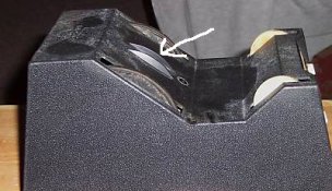

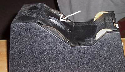

    I've got a Beseler 8922 motor base and drums that have been sitting around, unsued for a few months. The issue is that the tabs protruding from the base prevent the drum from contacting the moving wheels. Is there something obvious that I'm overlooking here? Is there an adjustment inside for the wheel height or did this particular example get it's wheels pushed in? I could cut the tabs off and be done with it but I assume they're present for a reason.
    attached photo isn't my exact specimen.

    This isn't normally a problem unless the rubber covering the drive wheels is missing. As far as I know there is no means of adjusting the height of the drive wheels.

    If the outer plastic case is not seated properly on the metal base, it can alter the position such that the tabs will not allow the wheels to make contact.

    I removed the two rear screws on the plastic housing and pushed the base upward. I can't see anything bent or broken. I'll have to dril new holes in the housing to replace the screws. Problem solved.
