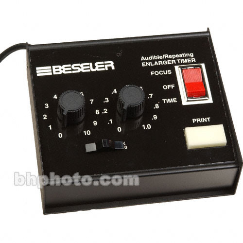

    I got a Beseler Audible Enlarging Timer off of ebay. It's in great condition but there is something quirky about it.
    The dial on the left is whole seconds and the dial on the right is 10'ths of a second.
    There is also a switch below the dials to use 1x or 10x for the timer.
    I can set the seconds and the fractions of a second and they seem to be ok, but when I'm doing something like "28 seconds" or "32 seconds" it never comes out right.
    Example: I turn the switch below the two dials to 10x and I set the left knob to 1 and the right knob to 0
    Should I get 10 seconds?
    I get 12 seconds and I'm not sure why.
    I'm not ever sure what I should get and I've tried setting some and checking it by the clock but I can't figure the system out. I don't have an owners manual and haven't been able to locate one.
    Anyone have one of these and can clue me in?

    yup you are doing it right. the beeps aren't every second, so don't go by the beeps
    but by the enlarger light being on.
    if you can locate the foot pedal for your enlarger timer GET IT. it makes burning and dodging and everything else so much easier

    Consistency is what you want. These timers don't last forever. I have gone through at least 3 of them. The beeps aren't accurately a second but they are pretty close. My experience is that they are generally about a 10th second too short so that a setting of 11 seconds will get you 12 beeps. As long as it is always the same it is fine. One of my old ones got only slightly inconsistent so it took me a long time to figure out it was off a couple of seconds here and there and i developed the habit of counting the beeps to make sure it was always what I expected.

    I put the dial on 1 and 10x and watched a clock while it was one and it went on for 12 seconds. I double checked it to make sure.
    As it is, I have to double check each time I set a time because I'm never sure that it will stop in the right spot. I'm not sure it's broken, but just that I don't understand how to use it.

    After some additional contemplation, I guess that (as was said) as long as it's consistent, it's usable. I did buy a Time-o-lite from Fleabay just in case though :smile:

    R10 adjusts the 1x time (clockwise increases time)
    R7 adjusts 10x time (clockwise increases time)
    R20 adjusts audio beep increments (clockwise increases time in between the beeps)
    This is what you need in case you have a hard time finding it in the old thread.
    I used a stopwatch and got mine on the money.

    Just be careful since the board is at line voltage. Maybe use an insulated screwdriver or unplug while adjusting.

    I just adjusted it with a stop watch and it's about as on as I could wish for.

    if you can find an audio frequency generator, set it to 1hz n adjust the tones by ear.

    Great darkroom timer. I sold mine years ago for a programmable one. But there a slider switch that has 1X or 10X. The left dial is single whole numbers and the right one is tenths. So if you have the You get 12 secs because you have the 10X selected because the left dial is set at "1" and the right dial is set ".2" . 1.2X10=12.

    i never "timed" my timer. i just know the beeps are not accurate.
    i also know, if it is consistent doing whatever time it does, whether it suggests
    10 seconds is really 12 or if 10 seconds is 7 ...
    consistency is really all that matters. if you know x always = y ... that is all that really counts.
