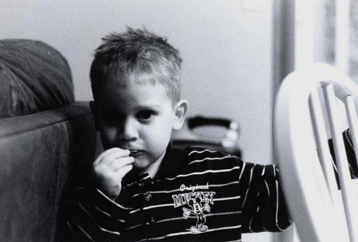

On Christmas I shot a roll of Bergger 200 that'd been in the fridge for a few months waiting for a subject... I generally use 400 speed film, so I thought I would get finer grain, but it's much grainier than I ever expected. So I don't know if I did something wrong, if this film is just like this, if it was in combo with the Rodinal, or what... I used my flash much of the day, because we were inside, but I am pretty such this one was natural light due to the shadow on his face. I developed in Rodinal 1:50 for 12 minutes, 68 degrees, enlarged to 6x9.
I don't necessarily dislike it, at least on this shot, but I was just surprised it would be this grainy at 200. Thanks for any thoughts. :smile:
(please excuse the dust marks, this was just a quick print, since my fixer was dying...)

You used 35mm? Yes, it can be very grainy in Rodinal. Calbe A49 is a much better developer for Forte 200, which is what this film is. Use it undiluted and grain will be very small.
