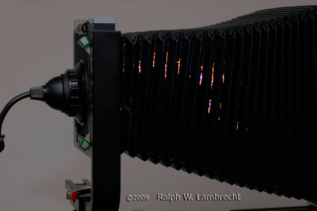

    I used liquid latex before I ordered new bellows from Custom Bellows in the UK.
    I attached two pictures:
    1. the equipment to check bellows
    2. the test result with leaky bellows

    Sometimes even Ralph's testing method doesn't show up all the light leaks. Recently I investigated an MPP MicroPress, the owner hadn't been able to find the persistent light leak, I only found it by firing a flashgun into the camera with the lens panel removed and a film holder in the back in total darkness. Even then the leak was only just detectable and was where the Graflex bellows attached to the MPP body. (The MicroPress is based around some Graflex parts).
