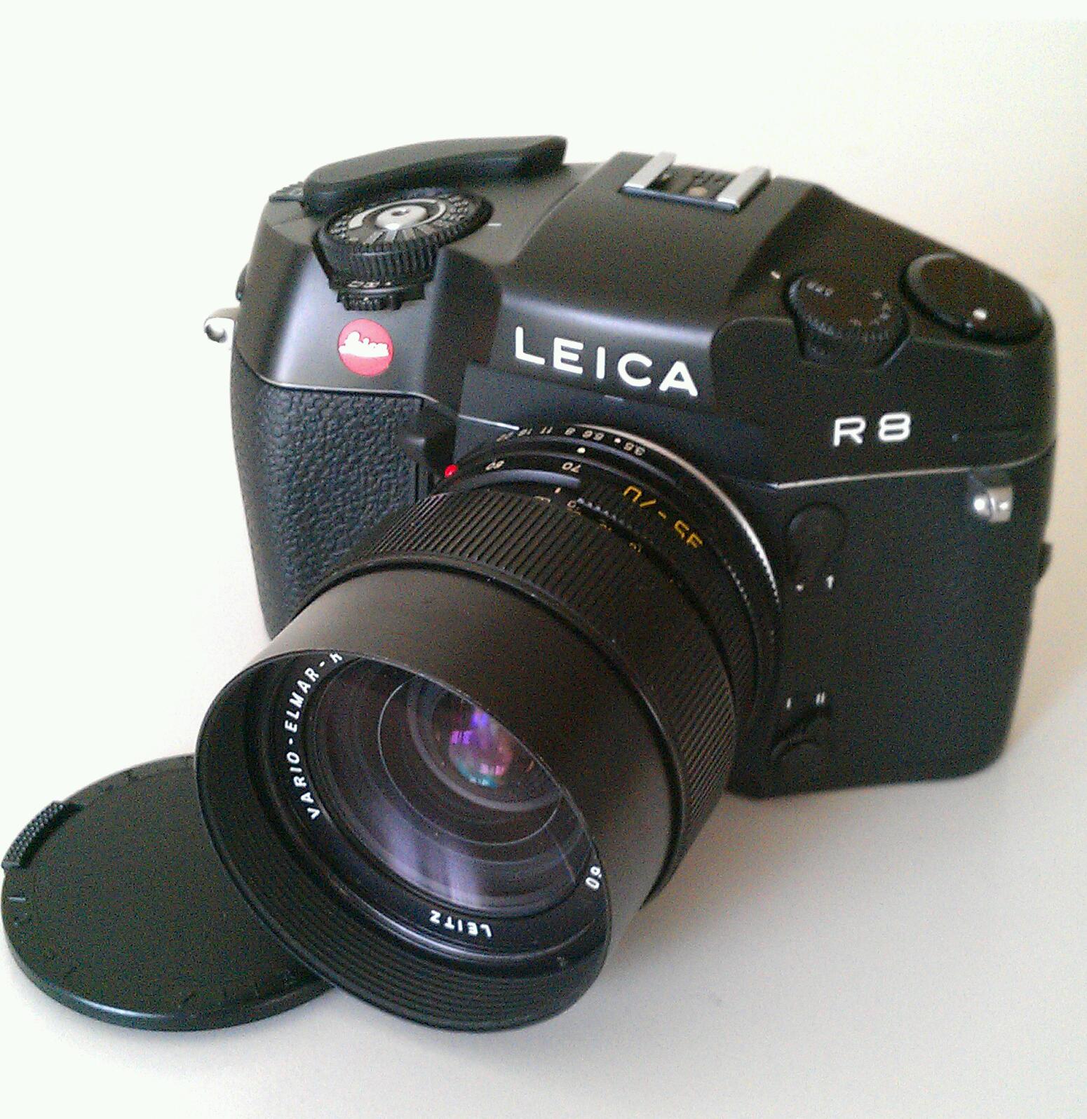

    Picked up a super thrashed on Leica R8. I've never seen an R Leica so 'used'. Guess not everyone babies them. Bought it because I wanted the lens that was on it - Gen 2 Summicron 50 3 cam - for my R9. This was one of those time it was cheaper finding a camera with lens than just the lens itself!
    Lens has outer wear, but glass is excellent. The 'free' R8? DOF lever broken - I don't care. Metering and shutter speeds seem accurate. But here's da weird thing. The camera only stops the lens down to F4. It goes slightly narrower after that but that's it. Does it with any lens. The Cron works perfectly on the R9.
    I don't really mind, because the R8 was a bonus, and with it's 1/8000 top speed, I can pretty much use it wide open all the time anyway. But I'm curious as to what could be the issue.
    Compared to the R9, this thing is waaaaay heavier. And it's weird there is no frame counter on the top. And strangely, I prefer that the mode dial is not locked. Guess people complained about that as on the R9 you have to push a button to unlock it which to me slows things down and is a pain.
    I never imagined I'd have a better cosmetic shape Zenit than Leica...

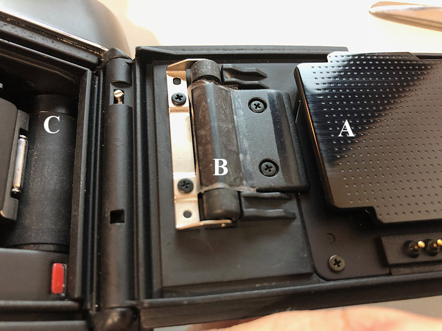

    Ok, so got the second test roll back, and it has the exact same horizontal scratch about 1/3 of the way up, across the entire length of film. I heard that this piece is to blame as it can wear out. Even though I couldn't detect anything sharp... I read that some had put a piece of tape on it as a fix. So I did the same and will see how it goes. Anyone else heard about this fix?

    Which side of the film is the scratch on?

    Reckon the edges of the tape are going to cause problems. That R8 looks like it's lived life to the full. Unless there's a point on the roll bar it wouldn't be my Sherlock moment, but sometimes you have to go with your instincts.

    On the shiny side.

    Just put my 3rd test roll in the camera. I'll see soon enough if the scotch tape helps.

  20. shutterfinger
    shutterfinger Subscriber
    Ads Enabled
    Messages:
    3,221
    Joined:
    Feb 25, 2013
    Location:
    San Francisco Peninsul
    Shooter:
    A. lot of wear here.
    B. metal edge appears to be even or above the center fixed area and the outer roller edge. Loosen screw to the left of the B and try to adjust the roller. needs cleaning with 90% alcohol.
    C. needs a blow job with canned air.
  21. summicron1
    summicron1 Subscriber
    Ads Enabled
    Messages:
    2,474
    Joined:
    Jul 28, 2010
    Location:
    Ogden, Utah
    Shooter:
    by any chance is that silver roller at (C) in the above picture not rotating as the film winds up? Looks pretty grimy, and if it were sticking it would cause the scratch.
  22. OP
    Huss
    Huss Member
    Ads Enabled
    Messages:
    886
    Joined:
    Feb 11, 2016
    Location:
    Venice, CA
    Shooter:
    Thanks for the input. I checked it before and it rotates. Plus the scratch is on the shiny side, so the opposite of what that would touch on the film.
    EDIT: I just got what you meant. The roller touches the outside(shiny) side of the film when it comes back around on the rubber roller. I wound the film back into the cartridge leaving the leader out so I could reload it, and checked it. It does rotate but I cleaned it with 91% isopropyl. Thanks for the suggestion.
    Funny thing is the picture makes the inside of the camera look filthy, but in reality it does not look like that. I guess the jpeg engine of my iphone picks up and enhances everything, for better or worse!
  23. OP
    Huss
    Huss Member
    Ads Enabled
    Messages:
    886
    Joined:
    Feb 11, 2016
    Location:
    Venice, CA
    Shooter:
    B. - I will try that after this film is done and the issue still exists
    C. - done that a lot already. The image exaggerates the imperfections. I was thinking about cleaning it with a q tip and 91% isopropyl but it is made of rubber and 'old' and I don't want to risk drying it out. EDIT - I cleaned it with the alcohol and it looks much better.
    Fingers crossed!
    Another observation - you cannot dry fire the camera with the back open. It needs to be closed so the contacts on the film door touch those on the body. Which makes it a bit annoying when winding/firing/cleaning etc.
  24. blockend
    blockend Member
    Ads Enabled
    Messages:
    3,845
    Joined:
    Aug 16, 2010
    Location:
    northern eng
    Shooter:
    You should be able to isolate the exact point where the scratch occurs by reference to the film, relative to the camera's interior hardware. If it's across every frame, the culprit should identify itself quickly. The elusive faults are ones that occur over a few frames every roll.
  25. OP
    Huss
    Huss Member
    Ads Enabled
    Messages:
    886
    Joined:
    Feb 11, 2016
    Location:
    Venice, CA
    Shooter:
    That's the thing, matching the scratch on the film to the body did not show anything obvious/visible to my eye. The R8 is notorious for scratching film due to item "B" in the image above that Shutterfinger so helpfully placed. "B" apparently wears and becomes rough with use, and this camera is seriously used!
  26. NB23
    NB23 Member
    Ads Enabled
    Messages:
    1,353
    Joined:
    Jul 26, 2009
    Shooter:
    Why is there tape over “B”?
