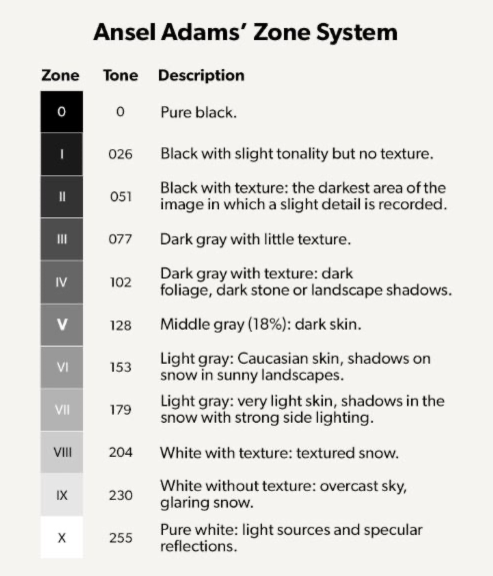

Hi everyone,
I was reading Ansel Adams book The Print, when it started to confuse me what he means by the basic thing of high & low values.
see page 79; The Print by A. Adams.
"the low-density areas (high values in the print) are determined primarily by exposure,
and higher densities (low print values) are then controlled by changes
in contrast. Thus we inspect the textured high values, about Value
VII-VIII, to determine the appropriate exposure time."
I think i reverse them.
Basically is a high value black or white?

This is a bit confusing
"the low-density areas (high values in the print) are determined primarily by exposure, Meaning bright areas of the subject.
and higher densities (low print values) are then controlled by changes Meaning dark areas of the subject.
Thank you so much Sirius.

Hi Doremus,
I'm just trying to understand the the sometimes confusing difference between low and high.
Do you mean then ,there's a difference between high and low, depending upon you talk about the negative or if you talk bout the print??
thanks.

Hi Doremus,
thanks.
Only that, in reference to the brightnesses in the original scene, the low/high density areas are reversed in the negative compared to the print.
We have to keep in mind that (as Vaughn points out) "low density" just means less developed silver in the negative or print and vice-versa.
A dark area in the original scene ends up being a low-density area on the negative (it gets less light) and then a high-density area on the print (because it gets more light through the low-density part of the negative). Conversely, a light area in the original scene ends up being a high-density area on the negative (lots of light hitting the negative) and then a low-density area in the final print (not much light hits the print).
That's the whole idea of "negative," where the densities are "reversed," vs. "positive," where the densities correspond more intuitively to the original scene (remember, white areas of the print, which correspond to bright areas in the original scene, are low-density).
Clearer now?

Well, it was a long time ago, but I do recall being confused by the wording myself when I first read that AA book. A simple diagram or picture adjacent to the page showing both a negative and its print, with appropriate terminological labeling, would have cleared that up that ambiguity. Even the basic Kodak guides did that, but didn't apply AA's personal ZS jargon. It would have been better if he had only spoken of print density being INVERSE to negative density, because that's what is really going on.
"Value" in his jargon has more to do with the original scene itself :
high values equate to bright things on the overall scale, like snow for example; low values to deep portions of the scene like shadows. Then there are the mid-tones. Of course, to make things even more complicated, "tone" and "value" in this sort of ZS dictionary has a different meaning than for a painter working with pigments. Here "tonality" refers to placement with the full continuum of gray all the way in between the brightest highlights and deepest shadows.
