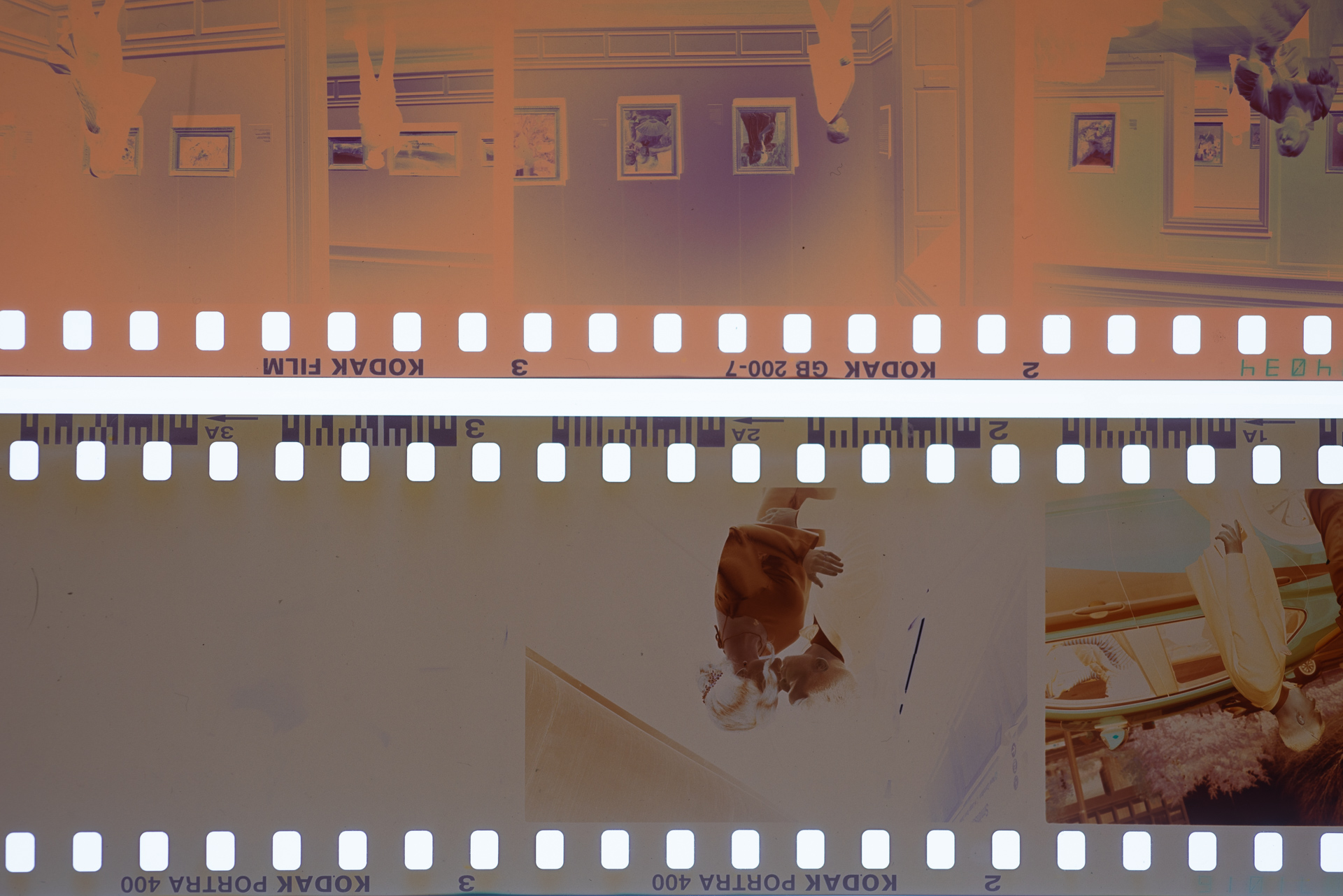

Greetings all, I have recently switched to using Flexicolor developer and am experiencing an issue with elevated base fog/D-Min compared to all the developers I've used previously. I was in contact with Kodak directly and they were unable to give me any good answers besides confirming my liter mix ratios were correct. They thought that the potassium ferricyanide bleach I use instead of the official EDTA could be causing cyan dye problems, but I have been using these chemicals for a year with consistent results and never seen this before. I ran a test strip through CS blix instead of the ferri bleach and saw no improvement. The developer has been pH adjusted to the 10.1 spec, no difference made there either.
I am using LORR developer replenisher without the starter. I am aware that the freshly mixed LORR is more active and can cause fogging in the first few rolls, but the issue has not resolved itself even after bromide seasoning with 20+rolls run through the replenished solution. I ran a back to back dev with CS powder developer and got a normal base D-Min, so it is not related to depleted bleach or fix.
All in all the developer is giving me acceptable results, but in some low-density sections of under-exposed negatives the shadows are quite muddy compared to other developers.
At this point I've run out of things to test. I had assumed that switching to Flexicolor would be an upgrade but that has not necessarily been the case. Here is an image comparing the CS powder developer (top) negatives to the Flexicolor (bottom).
If anyone has any ideas please let me know.

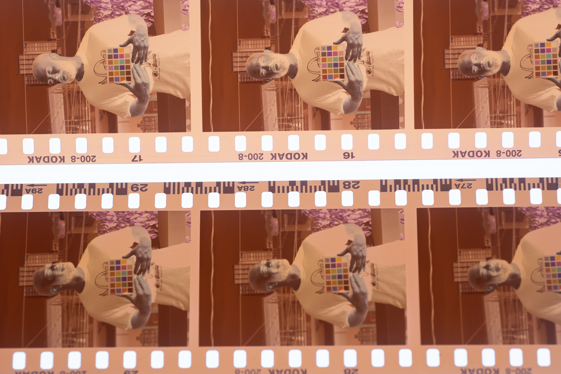

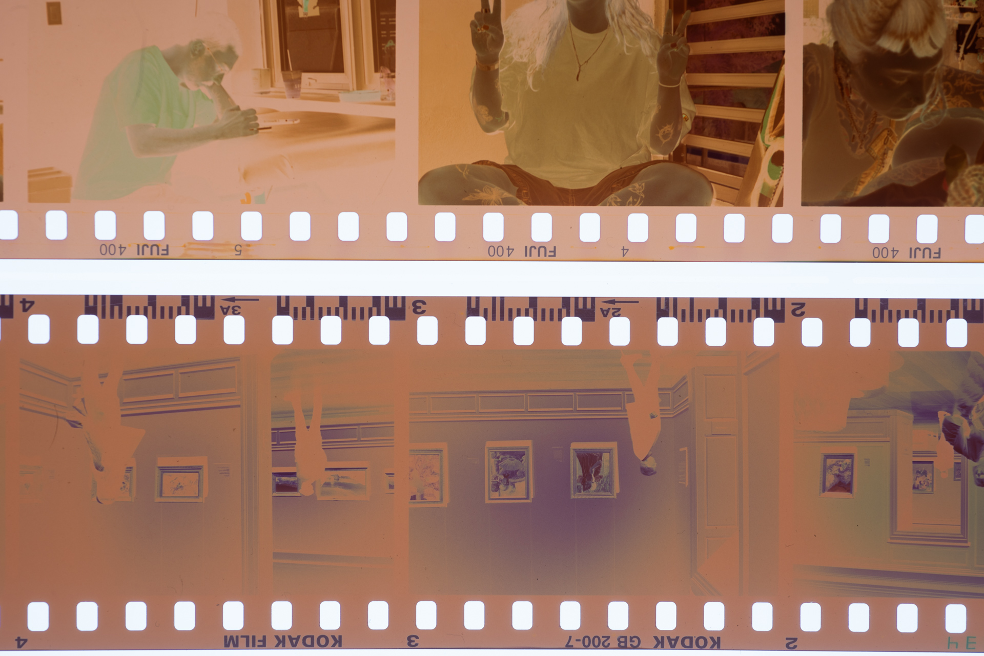

Unfortunately, I am still having issues.
I thought the fogging/thicker base density had resolved itself with the 20g/L SS clearing bath, but yesterday experienced an issue with a dev that left the color mask distinctly cyan instead the standard orange. The strange part about this is that it was only visible on two rolls of portra but not on the roll of gold 200 that I developed in the same tank. The gold does exhibit a thicker base density, but not a strong mask color shift. As you can imagine the portra rolls have a strong color shift in the conversions, but strangely enough the gold did not.
My first thought was that this was clearly a case of developer crossover because of the cyan bias of the mask, but the fact that the gold did not seem as strongly affected is confusing. The portra rolls have yellow surge marks on one side of the sprockets as well, perhaps indicative of staining. In any case, the color masks are varying noticably day-to-day in the same chemicals and same emulsions. Not great.
After I saw the affected color mask I decided to use CS developer on the next dev round to check and see if the issue was related to the (freshly mixed) bleach and fix. These rolls came out fine using the exact same methodology, so my conclusion is that this is somehow specifically related to the flexicolor developer.
I feel like I am chasing my tail. I do not understand why this seems to be an issue only with the flexicolor and not with the CS or homebrew developers. I've now got 40L of LORR so it's imperitive that I figure this out lest it all be rendered unusable.
At this point I have shifted to thinking it could be an over-agitation issue. I have been doing 15 seconds of initial agitation with 4 inversions every 30 seconds for years, but the official kodak literature says 30 seconds initial then 2 seconds of agitation every 15 seconds. In application, 4 inversions can take 8-12 seconds PLUS whatever additional time it takes for the developer to fully come to rest again in the tank. This is far more than the 2 seconds kodak outlines, which would essentially just be 1 inversion every 15 seconds.
Could over-agitation cause this density and/or color mask shift? It could explain the surge marks around the sprocket holes, but those surges are only present on the portra not on the gold. I have raked through the internet trying to find information on how over-agitation affects the color mask but haven't found much.
I have included comparisons. One is between the portra and gold developed in the same tank, the other is a fuji 400 developed in CS developer vs the gold developed in the flexicolor. The variations are easily visible.

No,this isn't due to agitation. The first things I think of with the very cyan Portra film is massive xray fog due to carry-on CT scanner damage combined with insufficient fixing.

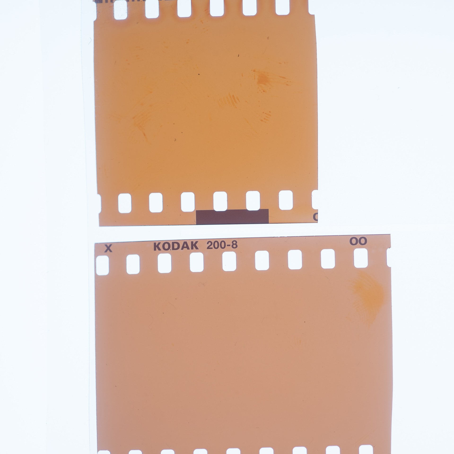

I just ran a test to see if there were any noticeable differences between the agitation methods. I think there may be some conclusive results here, barring an unknown error on my part. I developed two blank strips from a fresh roll of film to purely compare the mask. I used 2% stop and 20g/L SS clearing bath.
The method of one inversion every 15 seconds shows a much cleaner film base more in line with what I have come to expect. Comparing the white balance to my fresh CS control they are nearly identical, whereas the WB of my initial fresh flexicolor test was far off that control mark. The method of 4 inversions every 30 seconds displays an uneven mask color and color/density shift that I have been seeing in the recent flexicolor devs. There are a couple fingerprints, but we can probably just ignore that.
I will be updating my agitation method and hopefully that is the end of my woes.
The portra rolls did go through the airport but supposedly were hand checked...maybe security did a fake out. The fixer was fresh so they should've been fully fixed.

This really cannot be explained by agitation. Something else is going on.
Sure, an angry god perhaps.
All aspects of the methodology are the same. Stop bath plus clearing bath should eliminate any risk of developer crossover to cause staining. Dev temps identical. Bleach and fix identical. Wash cycles and temps identical.
And yet the recommended agitation method gave better results and while also being the only variable? Call me crazy.
Still none of this explains why there is such a gap between the CS/HB and EK chems. If this is staining caused by the ferri bleach then why did my test with factory blix render the same (actually worse) result?
Zero answers.
