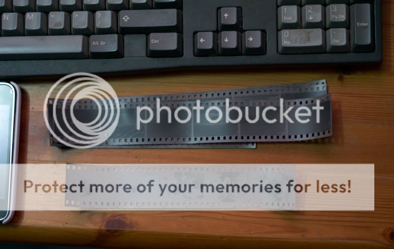

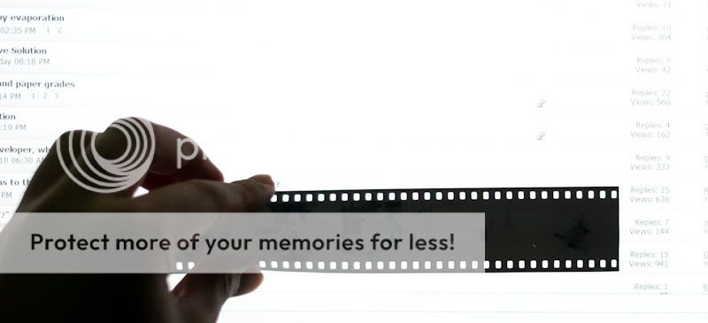

I'm fairly new to developing but I've managed to develop 4 rolls of Tri-X pretty well so far. However, the last roll I tried to develop ended up like this :
Reflective side
Underneath
This is Tri-x developed in id-11 and fixed using Ilford Rapidfixer at the same temp/time as the previous rolls. The parts that should be clear are very opaque.
Is the fixer bad? Or is it the developer? Both are fairly new, bought it two weeks ago and the previous rolls were developed 3 days ago without any problems. Any feedback is greatly appreciated :smile:

Probably the fixer. Try refixing one strip in fresh fixer for the recommended dilution + time and have a look again. I'd also put the strips away from light, they may print out.

Can't really tell from the picture, I'm afraid. However, underfixing can easily be confirmed/denied by refixing in fresh fixer and see if it clears. And no worries from over-fixing. So that is the first diagnostic to do. Like right now, eh?

Thanks for the quick replies guys, I tried fixing it again and it worked! No idea what I did wrong the first time though...
