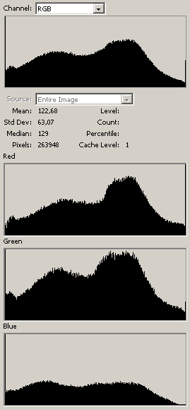

Mustafa Umut Sarac
Oct 29, 2006
4,926
İstanbul
I had been recorded many images but they were wide angle forest and city pictures.
I dont know this image has told quality but let me post it , this image comes from same family but its too dark.
Umut

Q.G.
Jul 23, 2007
5,535
Netherlands
The histogram(s) of that image aren't flat when i look at it/them.

Mustafa Umut Sarac
Oct 29, 2006
4,926
İstanbul
yes , histogram of this image is not flat but the lost ones had have . I will try to find at net again

Q.G.
Jul 23, 2007
5,535
Netherlands
Hang on - what are you (we, possibly) attempting to compare here ?
The histogram from one digital representation of a scanned image to a digital camera originated image of what I'm assuming is another another scene ??
I think we are trying to figure out whether being an Autochrome does something special to the distribution of tones.
One thing to establish before we start thinking about that is indeed whether there is something special about that, i.e. whether histograms of representations of Autochromes indeed would/could differ from histograms of represenations of other images.
If so, there is a possibility that such a difference could (!) be due to the nature of Autochromes. If not, there's nothing to think about.
