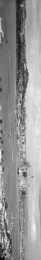

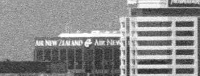

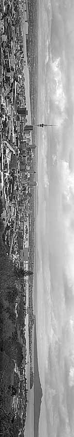

Finally got around to scanning the negs.........you Auckland guys will know these shots well and probably shot them before. My angle on it is trying to get as much detail on the neg as I can then printing metre long panoramas.
They are shot on 70mm strips loaded into 5x12 holders, I also shot lots of 5x12 film but at this stage wont use them. The difference is in the emulsions I used, Forte 400 and Efke 100. I prefer the larger grain of the Forte. Developer is Pyrocat HD.
Lens is a 210 W Fuji.
Sorry about the picture orientation, this is a common problem with displaying panoramas on the web. You'll see from the section enlargement there is reasonable detail, the building sign is 4 kms from the camera.
Clayton

Nice stuff.... Where did you shoot these from? It looks like a great view of the city.

The one with water and boats in the foreground is from Mt Victoria in Devonport, the city buildings are 4 km from that position. The other shot is from Mt Eden which is close to the city and is always full of tourists and their digi cams. The 2 shots took 4 hours to complete, the weather way constantly changing with rain coming and going.
For the first time (for me) I had the 5x12 setup at Devonport and someone came along and asked me if it was a Hasselblad........I felt quite privileged to be asked that question as I was beginning to think it was a myth!
The 2 photos I shot the previous year with different equipment and the results were quite disappointing. That led to the purchase of the 5x12 which I'm now happy to say worked out just fine.
