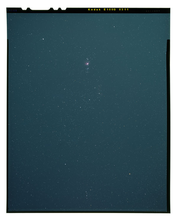

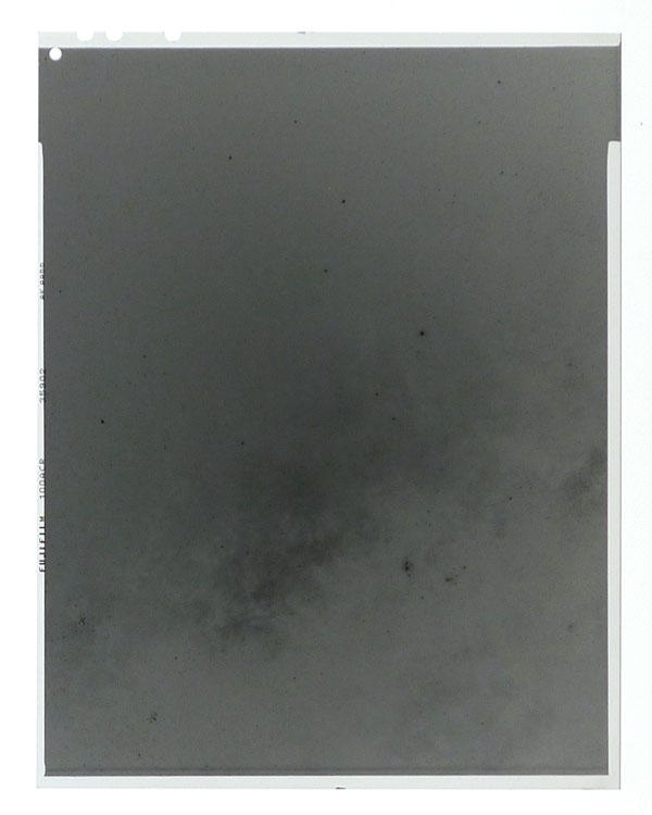

I've been making wide field astrophotographs for some years now. My work is primarily in b&w. Fuji Acros is your best bet for this. For color Provia worked well for me. Medium format is bulky you say? The astrophotography work I do is in 4x5. Never say never!
Fuji Acros and old Kodak E100G examples below. Straight scans, no manipulation. I don't have a scanned example but Provia will have the same look for color astrophotography.
