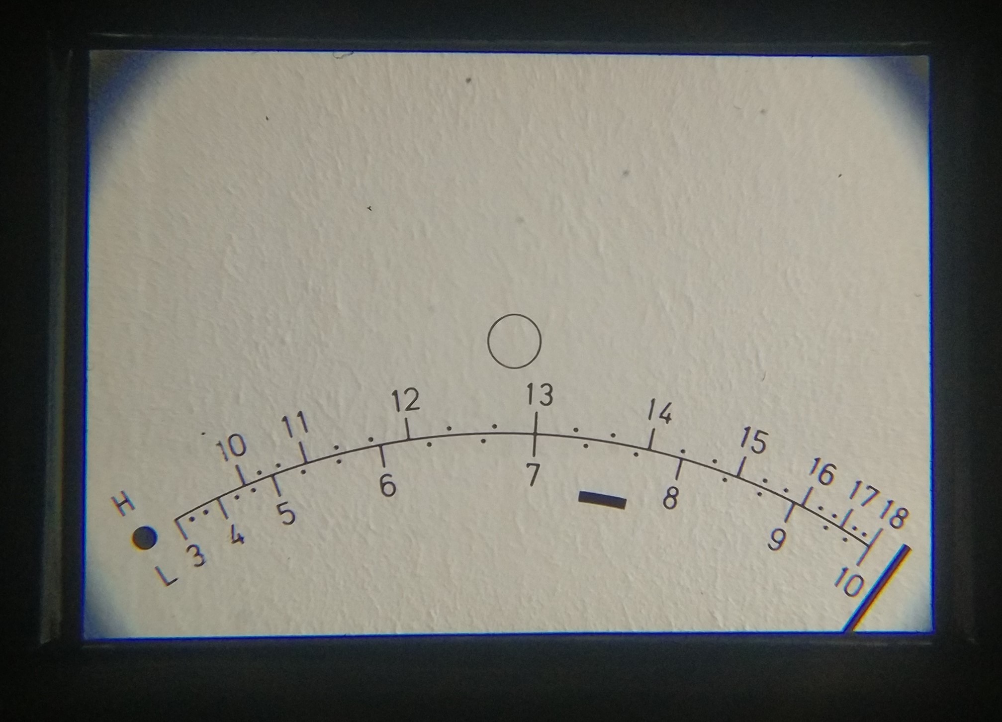

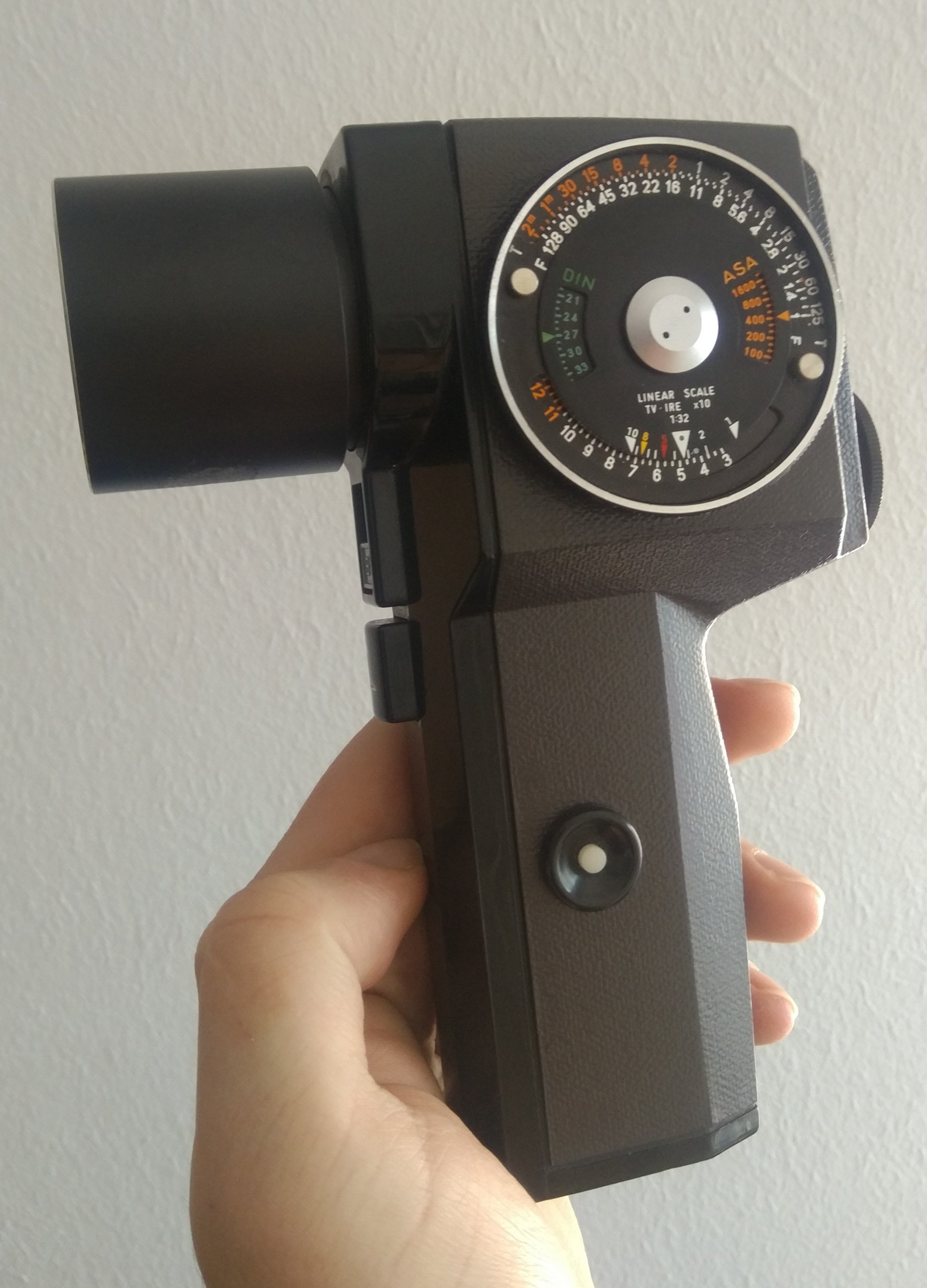

I recently bought a Asahi Pentax - Model III spotmeter. I'm not sure if I do anything wrong or it is defect. this are the settings: settings.jpg

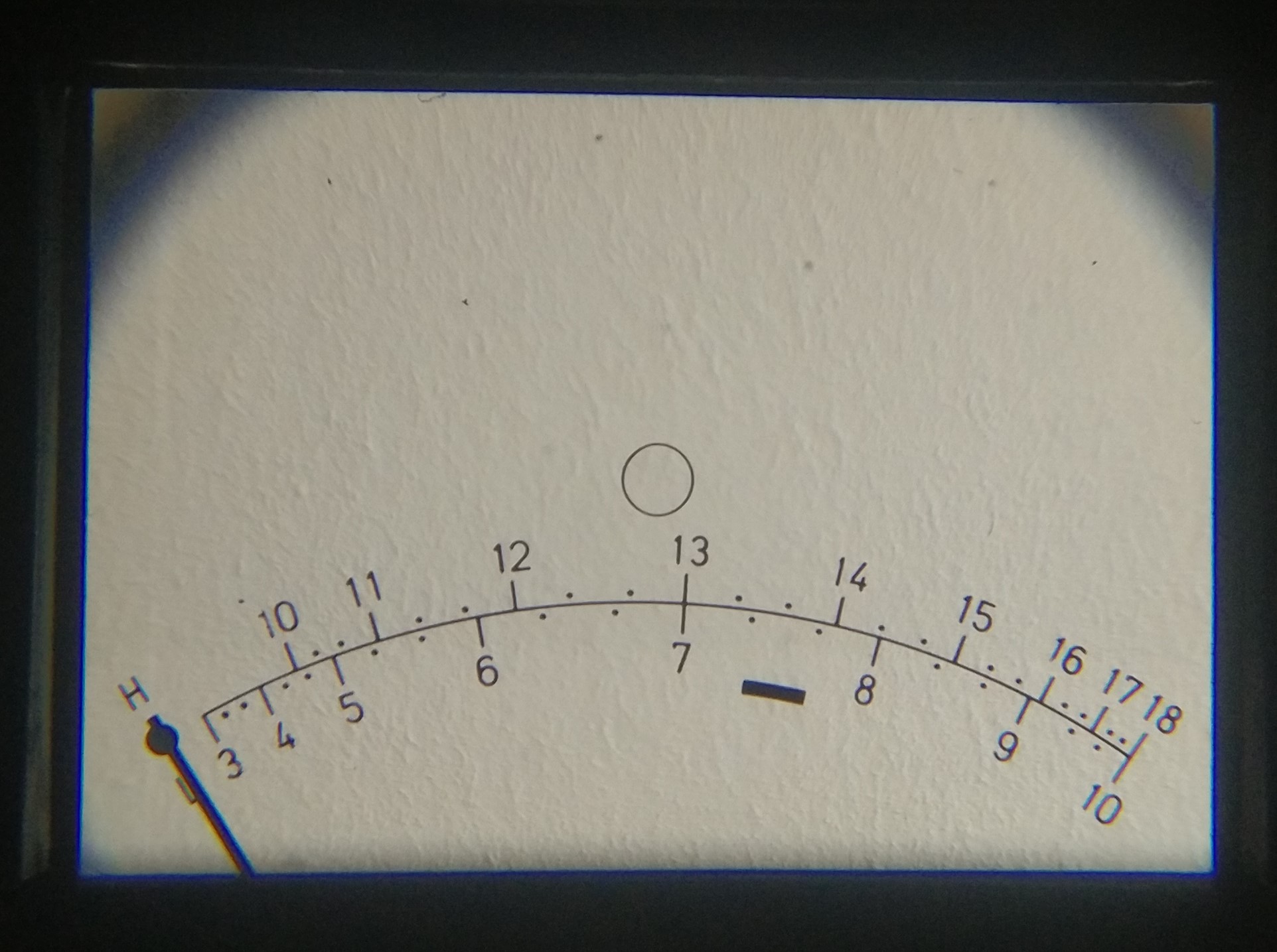

I pointed it against a bright wall and I don't press any button, the needle isn't deflected at all:
Then I press the button to go into the low range but the needle exceeds the the scale:
I guess the high range is defect, or am I doing something wrong?
