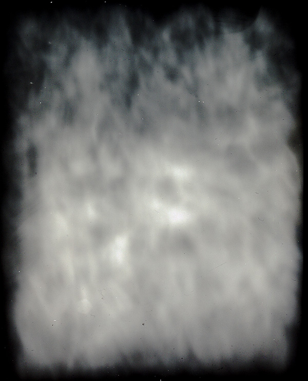

    Hi, I use
    Arista APHS Premium Halftone Supreme Ortho Litho Film
    Today i wanted to copy some negs and I found out that it had strange clouds. i did several tests with several different packages 4x5,8x10 and 10x12 with the same result.
    I tried to develop without light, same problem.
    I exposed it for 1 second at F8 (no neg in the carrier) to get a gray result, but also the same result.
    I develop with diluted paper developer.
    The film is about 2.5 years old. Always kept in fridge.
    Is there a limit in time for these films?
    Should I use rodinal in stead of paper developer?
    In the past I did not have this kind of problem. That's why i think it has to do with aging of the film...

  13. OP
    Willie Jan
    Willie Jan Member
    Ads Enabled
    Messages:
    931
    Joined:
    Jun 11, 2004
    Location:
    Best/The Netherlands
    Shooter:
    I got some agfa graphic film (15 years old..) and tested it also. This had no problem...
    So the develop should be ok. (i tried rodinal 1+100 and 1+50, same result.
    What i also saw is that the 4x5 sheet is darker around the edge of the film. Just like paper that has been in a hot area to long and after development you see the darker area from the outside going to normal towards the innerside. (looks like a centre filter is used).

  15. OP
    Willie Jan
    Willie Jan Member
    Ads Enabled
    Messages:
    931
    Joined:
    Jun 11, 2004
    Location:
    Shooter:
    i attached an example of a scan of a arista aphs 4x5 film.
    contrast is adjusted so it is better visible.

    This is the answer to your problem, sort of. I did this by lifting corners and pulling the film out of the tray with my fingers; 30 seconds out, then 30 seconds in for the full time of development. This solved the edge problem, but made noticeable marks from the heat of my fingers. What I did next was to use a sheet of fiber glass screen to set the film on while in the developer and lifted the film out by the corners of the screen. The film will stick to the screen as you lift it. It worked very well, try it.
    Of course this was under safe light conditions in open trays.
    I should add that rocking in a tray with this film does not work well if you are going for continuous tone.

    I would say that your development is incomplete. I suspected it before, but the picture backs this up. One minute is a short development time for film. The development of a sheet of film starts at the edges, and works its way to the middle.

    How could that be true if development is time and temperature dependent, among other things?
    While I agree that development is incomplete, the problem is that the edges have received more development than the middle. The same problem can occur by using a tray to small for a sheet of film such that the turbulence at the sides of the tray cause uneven development.

    I'd say that the problem is agitation. There is turbulent flow around the edges of the film but the center is stagnant, what one would expect with tray rocking.
    One doesn't see it so badly on prints because they are developed to completion and the paper isn't as flat as film so there is more turbulence when the tray is rocked.
    Continuous tone development of lithographic film is very sensitive to agitation because it is drastically underdeveloped and overexposed to tame the contrast - needless to say the film has great potential for further development.
    The standard agitation for sheet film is to develop several sheets at one time, pulling the bottom sheet from a stack, draining it, turning it 90 degrees and putting it on top of the stack.
    When doing only one sheet the same agitation pattern should be followed.
    It may be something else, but I would try the lift and drain technique and see if the problem goes away.

    That phenomenon is the definition of bad agitation.
    And of course the development is incomplete - drastically incomplete development is the whole point of the exercise. If it were complete it would be a black-or-white no mid-tones lithographic image.
    Even normal film is never developed to completion, that's why you can overdevelop it. Stand development, where development stops on its own accord, is controlled by developer exhaustion stopping the developing action. Try 1-hour stand development with full strength D-76.

    Regardless of time and temperature, the film has not been developed long enough. Perhaps "incomplete" development is a bad word to use, since, as Nicholas sez, all continuous tone results are "incomplete". What I meant was incomplete in terms of what was expected from the film in this scenario, not incomplete in terms of what density the film is capable of achieving. (If one wants to play that game, no piece of film has been completely developed until every bit of exposed silver on the whole sheet is maximum black.) Let me say "too short" a development time instead. A sheet of film in a tray starts developing like this with constant agitation this way and that way. You can see it on litho film in developer and the fixer. If you extend development time so that the period of time that it is uneven at the edges becomes a smaller percentage of the total developing time, and/or slow your agitation routine, and/or just let the film stand, and/or entirely lift and drain the sheet, it is not noticeable on the film. When I said development was not complete, what I meant was that the middle of the film had not yet developed, though the edges had. It is a given that the edges have received more development than the middle...that was the clue that led to the idea of developing time being too short.
    For what it is worth, my developing times for continuous tone on this film are in the three to five minute range (with HC or LC-1), and I use a long pre soak. For halftone results, one minute in AB developer finishes the film pretty well, though I usually do two anyhow.
    Another issue is that film exhausts your chemicals very quickly compared to paper. I always used my HC one shot (or two shot), and have to replace my fixer very frequently according to the hypo check drops. I'm supposed to get about 25 8x10s-worth of film from my Liter of fixer, which should be 50 5x7s plus test strips. I get about a quarter of that before the fixer loads up with silver using litho film, however. I imagine that it similarly kills developers quite quickly.
    Also for what it is worth, I develop all my in-camera sheet film in trays the same way I develop litho film, and the edges are not more dense than the middles, except with very short development times. (Attempting to test for N-2 with D-76 stock solution is one specific example that I remember, ad even then, it was only really noticeable with a densitometer.)

    This image was developed at 20 C for 2 minutes.
    I also developed one for 5 minutes, same result.

    I can't suspect it has to do with my development.
    1) i never had this experience in the past
    2) a sheet of agfa graphic film probably 15 years old was perfect developed!
    The edge of the film is turned black prior to the middle because in some way it is darker than the middle eventually....
    This has nothing to do with tray rocking. I never had this problem with which kind of paper (baryta/rc/...).
    Lifting the film out of the tray at one corner can create a line where the developer runs of the film like a river.
    I also had this with lith development.
