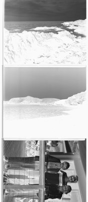

Here's a scan of three shots at once (if I do them individually then it changes pareameters and the results aren't comparable).
Top is the 'almost decent' one with the orange filter in Perceptol.
Middle is the 'rather thin' one in Perceptol.
Bottom is for comparison, from the same packet, ei100, 1:100 rodinal stand for an hour, to show what 'fully' dense looks like compared to the top two (although even with this one the highlights aren't blown out).
Still, not to say that the top two are no good, but they'll just need a bit more work in the scanner/enlarger to get looking good. But I'm definitely going to add some extra time in next time I rate at ei100.
