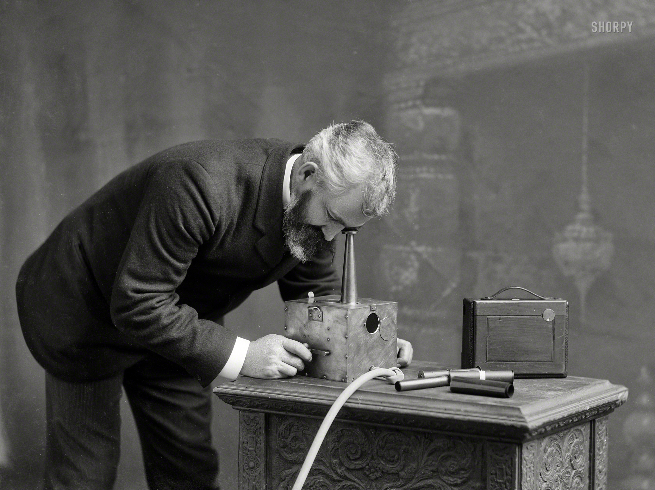

The apron method of tank development is, as far as I can tell, the earliest method of tank development employed. The history of the apron method dates to 1900 or thereabouts, and the inventor A.W. McCurdy, seen below with an early developmental daylight film tank.

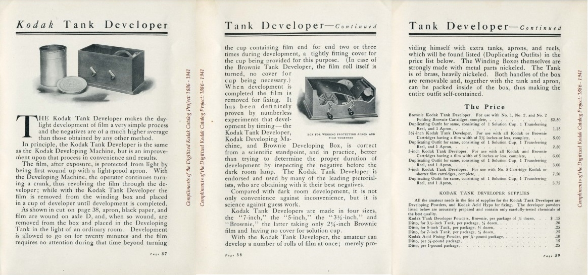

After further developmental work, McCurdy presented his design to George Eastman, who bought the patent rights to McCurdy's developing machine in 1902. This would be put on the market as the Kodak Developing Machine, later called the Kodak Developing Tank. This illustration from 1907 shows the tank in use:
The following catalog excerpt from 1907 describes the apparatus. The usage of the loading machine and tank allowed the development of roll films in full daylight with no changing bag or darkroom necessary. To begin with the film was constructed slightly differently than we are accustomed today. Attached to the end of the film itself was a 4" long piece of paper. After shooting a roll of film, the photographer would unroll the backing paper until this tail appeared, and then tape it to the backing paper. This meant that the film would be attached to the backing paper on both ends, and not curl up when the backing paper was taken off the spool. At this point, the film and backing paper, still rolled on the spool, would be placed in the loading machine with the reel and opaque apron, where the film (backing paper and all) would be loaded onto the reel with the apron. This system is quite similar to the modern day Lab Box system. Once loaded on the reel, the film could be removed and placed in the tank for development.
