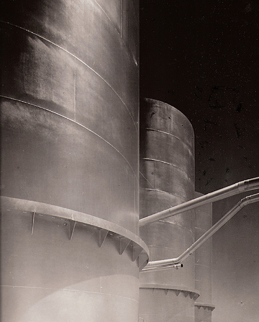

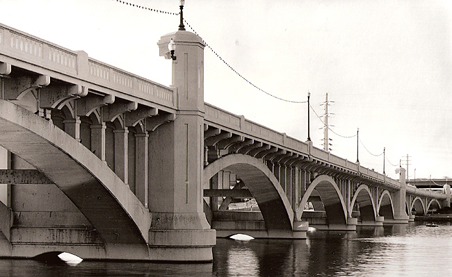

I use JandC Nuance (Adox) almost exclusively for my fine prints. That paper has given me the best print tonality and deepest dmax of any paper that I have tested. I develop this paper in the MAS Amidol formula.
I have used Oriental graded which in my experience was better then the Oriental VC. It is, however, not up to par with the Nuance paper.
I have no current warmtone graded favorite. The warmtone paper that I continue to appreciate is another JandC paper (PW Classic). It however is a VC material.
These two images are made on these two papers.
