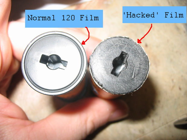

There's an Instructables post out there showing how the plastic 120 spools can be modified, trimming the lip down and sanding them thinner. I did this for one roll to shoot it in my great grandfather's Argus 40 and it worked great. I was really worried that dust from sanding the spool ends would wind up on the negative, but i was careful. The film seems to be wound tightly enough with plenty of extra paper wrapped around it that no dust got on it. I would consider doing this again over trying to re-roll it. But that's my only foray into medium format film.

Same as above rather than respooling I have luck with using nail clippers to clip the edges of the 120 spool and using sand paper to sand the top and bottom of the spool until it just fits the camera. I use a couple of old all metal 620 spools for the take up spool. I have a Tourister so not sure it the same process with work with a Metalist but may be worth a try.

I also trimmed the edges down on a 120 spool to fit. My camera is a Kodak Vigilant Six20, and there's some sort of light leak because almost all of the film was black. Trimming the spool worked to fit it in there tho :smile:

I'm not familiar with this camera, but for my Hawkeye, I trim the edges of the 120 spool every so slightly, otherwise you'll get edge exposure on the film. It rotates more freely in the supply slot. A 620 spool takes up the film in the take up slot.

fwir, trimming down 120 won't fit in a Medalist. Even the new plastic 620 spools can jam.

Yes, I tried the trim method and gave up on that real fast. The tolerances on the Medalist are so tight you just spend far to much time trying to get that 120 spool down to 620 size for the Medalist. The first time I tried it it was so tight that I got two or three frames then my counter went wonky cause the toothed roller was stripping the film. I then went to re-spooling, but not without beginners error. The first two or three spools went fine and the results were fine also. Then disaster hit! My son was playing Rocket Football and it was team picture day. Well, I thought I'd bring my Medalist along and get some shots of the team also. I re-spooled some Fuji Velvia onto 620 spools and headed for the practice field. I thought I got some great shots until I got the film back from processing. Most of the shots were fantastic, but there were two that showed my re-spooling error. One was the team photo and all the player were fine except the two on the end. That's where the film hump/bulged was. Their face had the right perspective, but their shoulders were about 50" wide. They looked like boys heads on pro-football players bodies. One of the boys was a friend of mine down the road. When I showed him those transparency's he said he absolutely had to have a print made of that one shot. He loved it and said he was going to put one on the wall of his office at work. I just cut the frame and gave it to him since I didn't even want to mess with it. That was around 25+ years ago or so and I've learned much since then. When I got my first Madalist I could still buy plenty of 620 Kodak in both B&W (Verichrome was my favorite) and color. I now re-spool using the re-tape method and have never once had a problem since. I have hundreds of cameras (yes, my wife tells me I'm a camera hoarding idiot), but the Kodak Medalist II is my No.1 favorite of all of them. Of course the Kodak Monitor 620 isn't bad either.
