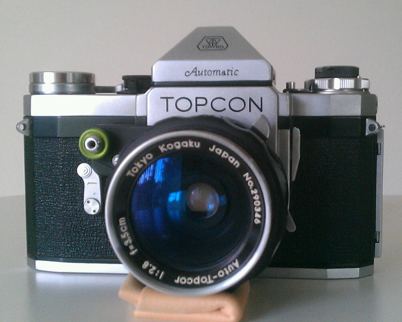

\/\/ 00 T !!! Just bought this very nice Topcon R II with 35/2.8 Topcor lens. Body is perfect, no dents or scratches, shutter looks new and is within tolerances for slow and fast speeds, the self-timer works, everything works. Note the slow speed selector. Best of all: 100% mechanical. The lime green aperture markings and release are original.
A very solid all-metal camera from 1960-1961.
I know there are a few Topcon owners here.
Topcon never quite made it through to becoming a leading manufacturer, they didn't sell in great numbers in Europe. In the US the Navy favoured the Super D which was Topcon's system camera and bought more Super D's than Nikon F's. Topcon's advertising claimed they were the camera of choice for the US Navy and FBI.

What are that lever, that knob for, at the left side of the lens. I assume the lever is the release of the mount-lock.
And that knob? For assisting twisting the aperture dial? Approach to that dial is quite hampered by that lever and the DOF/auto-diaphragm mechanism.

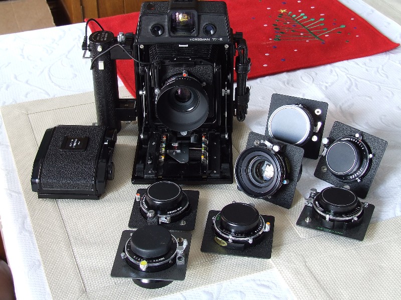

In a way, yes! Topcon and Horseman, made by the same company. These are all Topcor lenses.
It's an Exakta mount camera but the mount is twisted to the left on Topcons, the knob on the left top is the lens stop down and triggers the shutter release. I'm assuming it's like the Praktina lenses and early semi-Auto Takumars where you cock the lens to full aperture and then the release button releases the spring stopping the lens down, this trigger is inside the body with the Praktina and early Pentax SLRs.
Right, the lever releases the lens, same as on the Exakta.
The dial around the rewind knob loosens for attaching a flash bracket.
As Ian mentioned, the shutter release is on the other side of the lens compared to Exakta.
The silver lever on that lens is to manually re-open the aperture after exposure (the mirror is instant-return, but the aperture stays stopped down). Also, on this particular lens, to turn the aperture ring it is necessary to press in a small button on the ring (not visible in the photo).

The mirror is instant-return, but the aperture stays stopped down.
Thank you. This is the first time I learn of such feature combination.
So far I thought that all lenses that got such release mechanism located in front of the body release button would incorparate an automatic diaphragm, thus the aperture would open again once one takes off the finger from the release.
