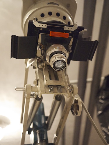

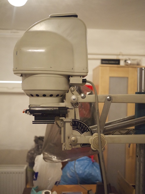

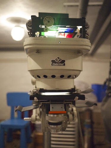

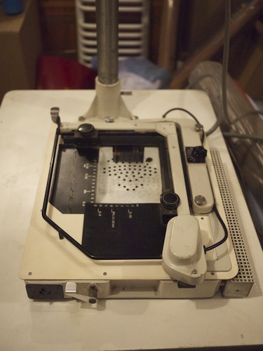

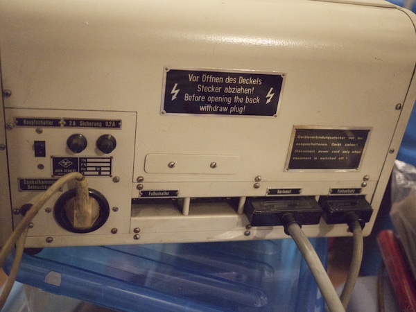

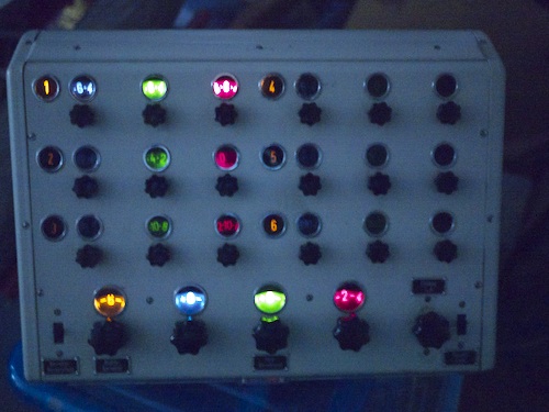

    Hi again everyone,
    I have taken some photos of the enlarger. Please take a look and share any tips you may have regarding this or similar enlarger.
    What you see in the attached pictures:
    1. Side view.
    2. Light path: light beam from the bulb goes via a thick lens, then is reflected in a diagonal mirror, then goes through another lens (this one is movable and, by sliding on rails, can be changed to a lens of a different shape).
    3. Filters. These are moved automatically by motors controlled from the color-mixing box illustrated further.
    4. This is where probably a part is missing -- I think there should be something here that moves the lens up and down for focusing. I can live without autofocusing.
    5. View from easel up.
    6. Front view with head cover off.
    7. The easel. It has 3 roles, I believe: holding the paper, measuring the light, and autofocusing. It is interconnected with the color-mixing box, and with the enlarger. When pressing the metal lever seen in the bottom, the enlarger lights up 3 times for 1/10 second or so each. This is regardless of how dense a negative I put in the holder. So, the light metering thing does not seem to work, or is missing something.
    8. The color-mixing box. It looks cool, but it does not seem to do anything, even though it is connected to both the easel and the enlarger. I cannot make it move the color filters.
    9. Back of the color mixing box.
    10. Box with lenses, holders, etc. Wooden, vintage look :smile:.
    What I would love to know is... well, actually ANYTHING about this or similar enlargers. Especially, if this can be operated manually, if there is any way to move the color filters, and if I can make any use of the easel and the color box.
    In the worst case, I will hard-wire the bulb to an electric plug and use a regular darkroom timer. But before I do that, I would love to hear ANY input you may have. Most of you are more experienced then me, so any tips are very, very welcome.

    Autofocus:
    The Colormat was a very advanced system. But though it employs a motordriven system in the colour had, the autofocussing is done, in contrast what you assume Adam, pure mechanical via cams.
    I assume the cam-system for autofucussing is hidden on the pictures you are showing.
    Exchanging the lens seems a bit complicated
    After inserting of the individual lensboard the main "lens" board has to be pulled up, the individual board has then to be clicked into place and the main board pulled down again. Then the larger ring at the very lens barrel has to be turned untill it clicks into place.
    Automatic-Exposure meter:
    At the right hand side you find a switch for the framing light and another for automatic-exposing.
    At the front side you find a knob for adjusting the meter to the sensitivity of the paper. Make test exposures, with variated settings of that knob. The setting with best result with a typical negative will be the standard setting for exposures on that paper.
    On the left side is a cable with plug to control size of measuring field.
    Filtration control board:
    I don't know.
    But it looks as if there are six basic 3-colour settings, a selector for those six settings, a 3-colour overrride-setting.
    However, the way the lamps are burning at your photo is contrary to my assumption...

    If you can get the green and blue filters to move in then it could be used for split grade printing. It actually would be pretty good for this purpose if you can get it to time and automatically change the two colors.
    In the usual split grade technique, you won't need a chart. Go by the shadows (blue exposure time) and the highlights (green exposure time).

    Cams:
    Agfa speaks of "finely grinded cams adhering to precicely adjusted rolls". Have a look again...
    Any ideas on that "switchboard"?

    from the pic. 5 it looks like the.. cam? is the grinded metal on the left side slightly off the body - on the pic. 4 the rightest arrow points on it. i think this piece of metal should be turned in a such way that the two rollers (middle arrow or somewhere around) will move that piece of metal. well - in case it is actually connected to the lens mount.
    try looking at focomat 2c or 1c - the AF system should bear at least minor similarites.
