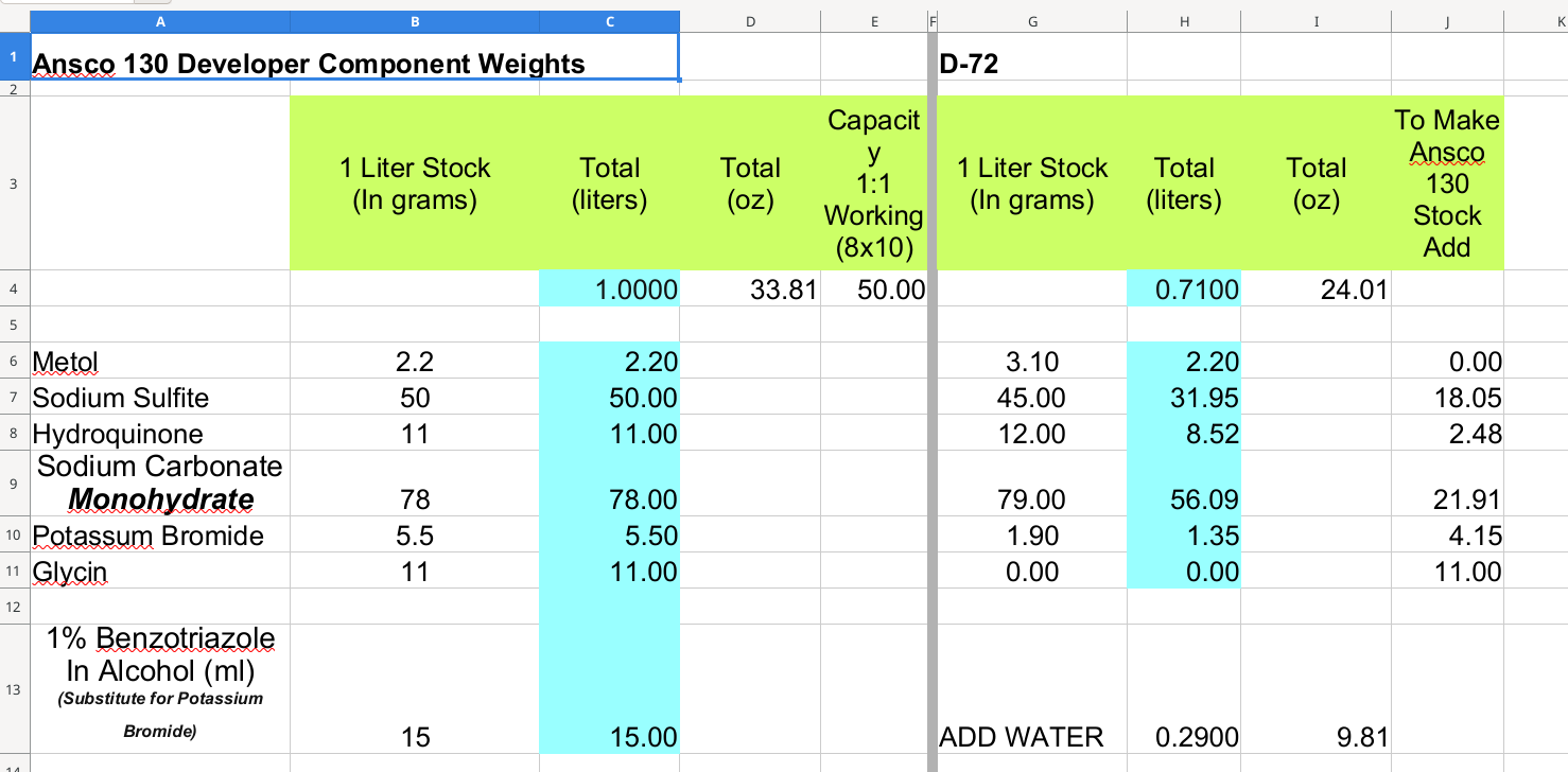

So I made the mistake of buying the 130 kit from PF to "try" it and I discovered that I really liked it. While subtle, the shadow separation is definitely better to my eye than Dektol. Moreover, the keeping properties seem to be as claimed.
The problem is that I still have a ton of the "new" Dektol (the not muddy brown kind) and I don't want to just sit there. "Well", sez me, "according to various geniuses here and there, the formula are quite close for the two but one needs to add glcyin." The problem is, "How much"? It then occurred to me that if I carefully selected an amount of Dektol stock to match the ingredient concentrations in 130 as best I could, I could top it off so that these ingredients were now the same as 130.
So I ginned up a spreadsheet to fiddle with this and came up with the following:
That is to say, if I start with 0.71 liters of Dektol stock and add the components shown in the far right column,
I should get what amounts to Ansco 130 stock once I top it off with water to 1 liter.

Took me a while to figure out why 710 ml of D-72 until I realized it was because of the metol.
If you got it to mix together, it should work fine. You can see that the Glycin and large increase in Potassium Bromide are what actually make the difference.

I raised the temp of the stock Dektol to about 120F with a heated mixing plate to get each component in solution.
I just printed some stuff with my first batch of "Dektol 130" as described above.
'Happy to report that this scheme works just as expected.
I now have a path to both consume my considerable stash of packaged Dektol at a very slow pace since the '130 formula at 1:1 can process around 100 8x10 equivalents with long tray and storage life. This is unlike the Dektol I was using at 1:2 as one session developer.
