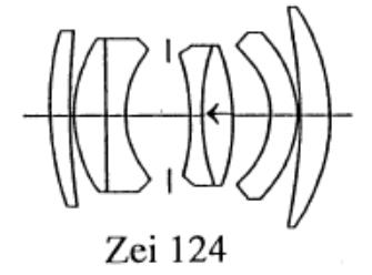

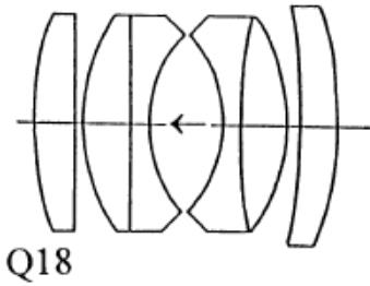

All large format/medium format lens I have come across were rolled over edge at the front of the barrel with the retainer ring in the rear, what i call the early design as this is seen in older lens, or rounded/rolled over edge at the rear of the barrel with the retainer ring at the aperture end of the cell's barrel. Front cells have the retainer ring at the front of the lens or its outer end. There may be exceptions to this.
The Planar 80mm f2.8 is either a 6 glass Gauss high speed or a 7 glass Gauss design.

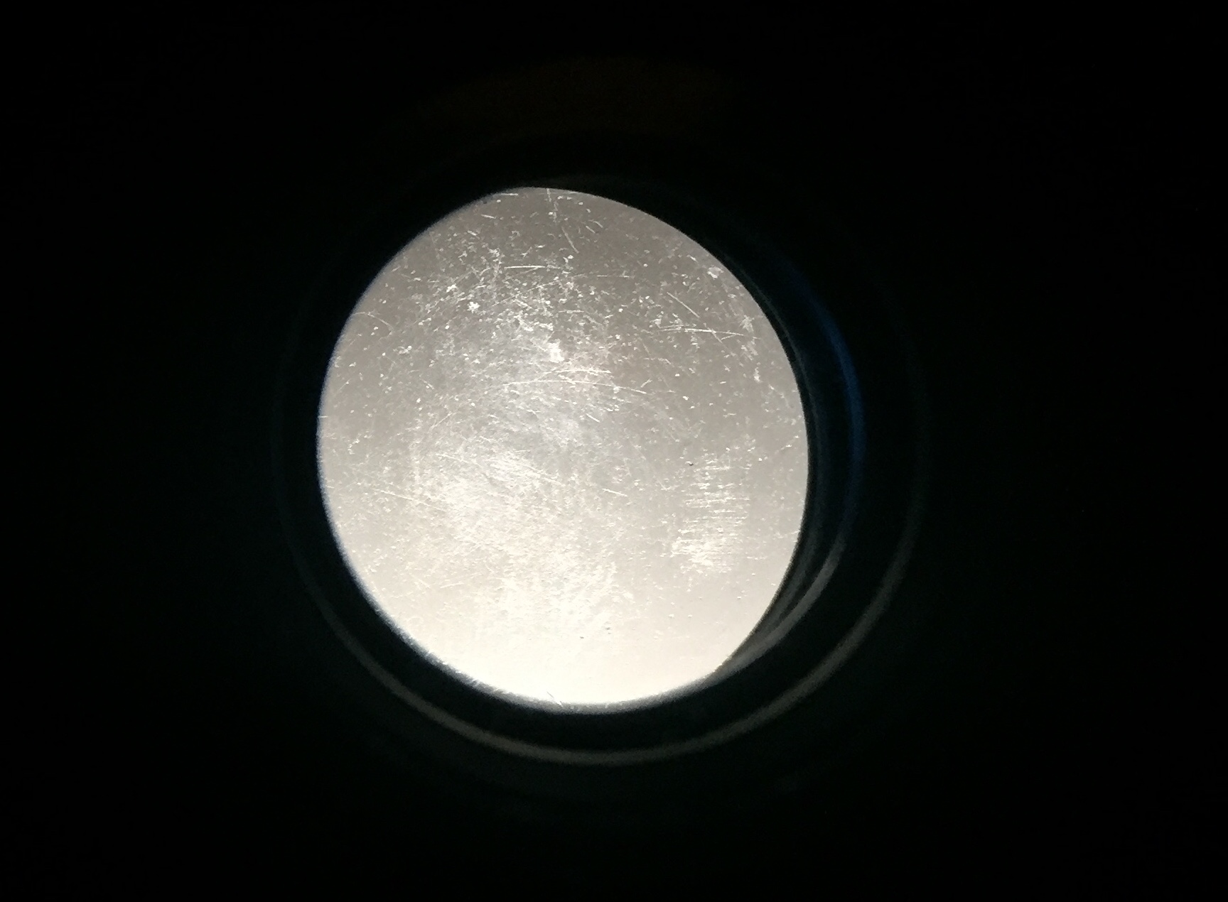

At least you don't have this problem:
No, that's not the Moon; that's the rear view of a Rolleiflex 3.5 taking lens element. THAT will cause a few problems...

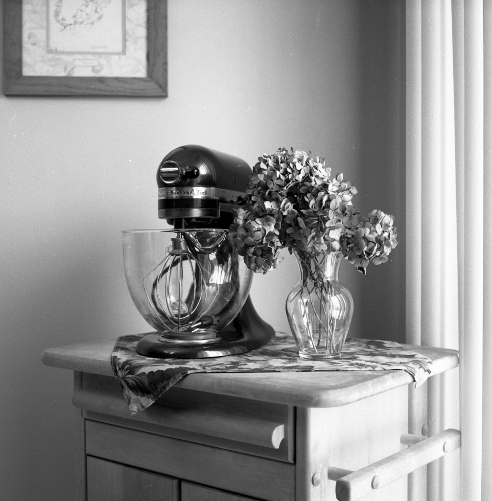

Here are a couple of quick shots from the first roll of the camera with the separation. The box was shot wide open. So far it looks pretty good. How exactly do I do a test to see if the separation is going to show up?

Campy, you will never know if the separation will continue to spread. Consider, it took 6 decades to get this far. I suggest you make the fundamental decision if you want to keep this camera considering what it cost plus the expense of a thorough cleaning and adjusting. If yes, send it off for a cleaning, leave the lens alone, and take great Rolleiflex photographs for the next 6 decades.

I haven't seen any reason yet to send it off for a cleaning, but I have only shot one roll. Everything seems fine and when and if the separation is a problem I will probably attempt to repair it myself. Is there some sort of test to really bring the separation into play that I can do?
