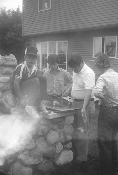

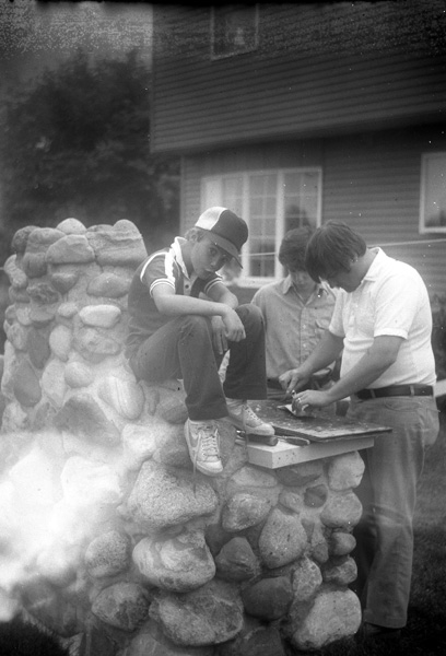

Well, the film turned out to be Verichrome Pan. I processed it this A.M. in D76. Obviously some fog and softness, but the fact that it produced a recognizable image at all surprised the hell out of me. Based on the images, these were exposed and left in the folder cam at least 30 years ago! Who says you should develop film as soon as possible after exposure.:D
