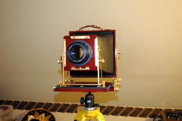

Well not withe the ladies but with the camera gear..
Its a 480/9 Apo-Nikkor.. which i bought for $40usd on ebay!!
came mounted on a huge 12x12 metal board with an electric shutter that works with 120V and a big aperture scale.. whole thing weighed 16lbs!!
Cleaned it off.. removed the lens and mounted it on my 8x10 tachihara board with a 92mm hole!
It is not as heavy as it looks and it is purdy..
Can't wait to use it on the 8x10 and make some blinding sharp negatives..

Here she is on the camera..

Congrats Deniz. I have one of these on my Calumet C1, and it's quickly become my primary lens. I mounted mine in front of an old Packard shutter and had been having and absolute blast with it. Negs so sharp that it can hurt to look at 'em.

86mm filters aren't too bad. The 105mm filters I have for another lens drop inside the filter threads on the 610mm Nikkor.

Deniz, I got a similar lens (won't quote you what I paid, but it was more than the $40 you paid) and have it mounted in front of an old Packard shutter as well. What is really fun is this lens and a 4x5 reducing back for my 8x10 camera. I had thought about taking a ring off of a Nikon 35mm lens and mounting my FM body to the 8x10 at some point. Who knows, might do it some day, but the 35mm is easier to carry than the 8x10, so it hasn't happened yet.
Congratulations on a sweet deal. Check into a Packard shutter, they still work very well and are easy to mount and use. tim

I have one of these 480mm Nikkors that I use on my 8x10 Wehman (with a Sock Shutter).
My lens has a filter (and Waterhouse stop) insertion slot in the lens barrel. I have a set of Nikon filter slips and I use gel filters in them - a simple solution to the filter problem.
