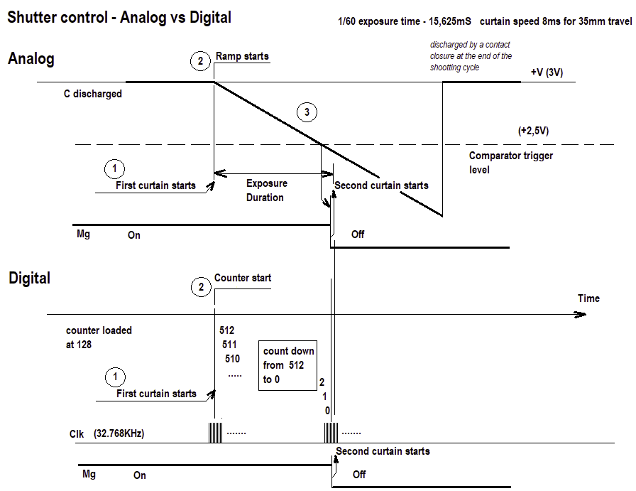

It was the early 1970s, and 35mm camera manufacturers were introducing electronic focal-plane shutter control, particularly to enable automatic aperture priority, simplify the speed control mechanism and simplify adjustment.
(Example: Minolta XM, XE-1, Leica R3, Cannon F1, Minolta XD, XG, XM, ...).
Then, in the late 1970s and early 1980s, they switched from analog shutter control to digital shutter control (and more) Example: Canon AE-1, Nikon F3, X500, X700.
The heart of the shutter control stage is therefore to manage the exposure time, time between the start of the 1st curtain and the 2nd curtain, nothing more.
The way the exposure duration is managed is very similar in analog or digital.
Fig 1 - Shutter control vs Digital. 1/60s.
The way it is implemented is very different.
Analog design: we use a Ramp signal to create a delayed signal
Digital: we use a Counter to count the time unit and create delayed signal

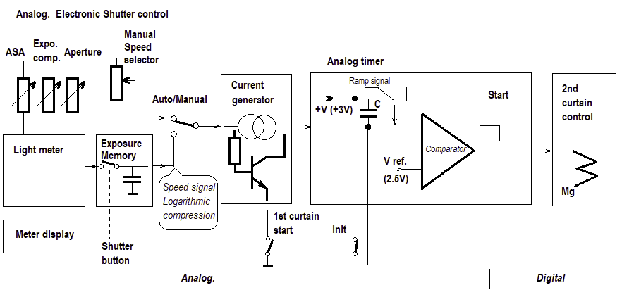

Analog shutter control: How it works.
Fig 2 - Block diagram Analog
The analog timer stage input and output:
input parameter:
- speed signal ex from 1/2000 to 8s...
control input:
- init (to initialize the circuit)
- start (synchronous to first curtain start, start the timer, in fact start the ramp )
output: start signal of the second curtain
The timer stage is able to create delay corresponding to speed parameter (ex from 0.4 ms to 8s).
At the input, the speed signal can take different voltage value and the voltage value is a direct representation of the speed.
It is easy to create such signal with speed selector (potentiometer) or with the metering system of the camera ( Voltage f(Light)).
A ramp signal is created using this input voltage. For that purpose we charge a capacitor C using a constant current generator (transistor). It gives a linear variation of the voltage during a time period. To create the delay we define a certain voltage level at which the Ramp signal will activate the second curtain. For that purpose we use a comparator to compare Ramp signal with a voltage reference. When ramp reach the reference voltage, the comparator output activate the magnet Mg that will permit to start second curtain. In fact, on mechanical side the Mg magnet retain the second curtain during the delay.
As it is analog signal, it is stepless. All voltage value are converted in a delay value or speed value.
To initialize the timer before each shutter cycle: We discharge capacitor C by a switch (activated after 2nd curtain start and until miror goes up).
To start the timer: we activate the current generator putting Transistor emitter at ground (Vspeed / R = Ib flows and create B x Ib = Ic at the output)
The value of the current controls the exposure duration: high current will quickly charge the capacitor (dv/dt high - short time); low current (dv/dt low) produce long time exposure.
In this example it is for 1/60, and a body with curtain speed of 8ms for 35mm frame window. The comparator stage integrates a delay stage to control/adjust the slot width between curtains at high speeds. This is the reason why there is a delay between crossing the trigger threshold and the command of the Mg output.

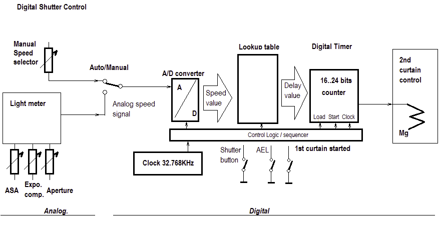

Digital implementation
WARNING: This is an example of implementation and not a copy of a precise camera.
In the digital shutter control, the timer stage is digital with a Counter and a Clock.
At the Init, we load a delay value in a digital counter. At start we decrement the counter at each period of a Clock signal. When counter reaches 0, the output signal is activated and start 2nd curtain. Counter is stopped.

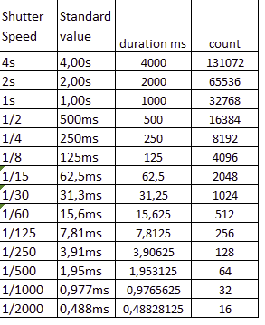

At the beginning, manufacturer used a 16 bits timer (or more) clocked at 32.768 KHz to deliver the delay and control precisely the 2nd curtain start signal. It permits to have a 30µS step and very stable delay from 1/2000 to several seconds with small timer size (16 bits timer). Manufacturer consider the 30µs step as "stepless compared" to the impact in EV on the film. At 1/2000 it is 6% of the duration, less than 1/10 IL. In fact the steps depend also how many bits are used to quantify speed. If we consider speed range from 1/2000 to 4s, 14 value, using 1/3 EV resolution it gives 40 speed value, easy to code with 6 bits A/D converter.
The clock is also used by Sequencer Stage to control A/D converter and counter (load delay value in the counter, start count). In several cameras, the clock is divided to generate other delay like: self-timer; Blinking self timer LED display; Meter-On timer; display timer activation.
At the input, the speed parameter stays an Analog signal. This signal can take different voltage value and the voltage value is a direct representation of the speed (scale depend from the manufacturer). This signal is converted to Digital (using Analog/Digital converter) and result converted to delay value using lookup table. The lookup table converts digital speed value to digital duration value. All values are predefined in a integrated memory circuit.
