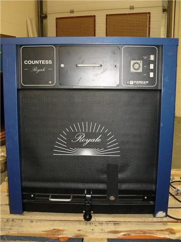

Okay thats good news Robert, just hope when i get my Parker Countess Royal 1k unit (see atached a pic of it in the warehouse) that i dont have any problems as i really want to print larger. Thanks
