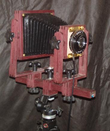

I built mine from plans about a year ago. I made some changes, but I'm more of a woodworker than a photographer. I used Purpleheart for the wood.

That purple heart one is pretty too.
Oooohh - box corners... I go weak in the knees for box corners...
