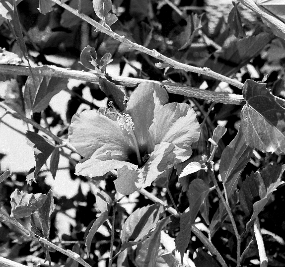

I've found that the best developer for my APX (100 & 400 alike) is Agfa's Studional aka Rodinal Special in Europe. A completely different tonal pallette than Rodinal, smoother, and super fine grain.
I process 1:15 for 6.5min @ 20C. Here's an example
Rodinal Special (not having anything to do with Rodinal, though) is a great fine-grain dev. I use it with Delta 100 for super fine grain when shooting landscapes on 35 mm.
