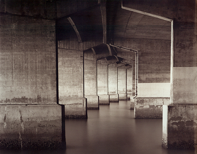

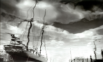

The Agfa papers respond very well to Veridon toning and I think this particular combination gives great results. As Titrisol mentions, it can give a tone quite similar to Chocolate in colour. If this is something that appeals, it's worth trying.
Like Veridon on most papers, the results can be variable, and need to be closely watched during toning. The longer the paper is left in the toner, the lighter brown it will go. It's a good idea to keep a wet reference print alongside the toning print so that the progress can be checked.
Personally I like to combine Veridon toning with Selenium toning, which gives a rich dark "chocolate" result.
The attached pictures show examples of the range of colours available, additionally to Titrisol's example. Both were toned on the same paper (Agfa MC 111 Classic - which gives a result quite similar to Premium) with Selenium and Veridon, with varying times. The columns being the longer of the two.
