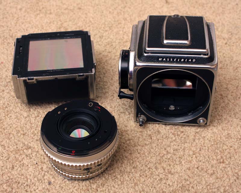

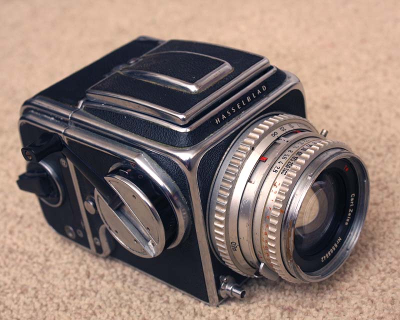

    Was just hoping for some input on my prospective purchase of a Hasselblad 500C/M. The unit is in fair/good condition, but I am trying to get beyond the aesthetics as I know Blads take a nice photo. :wink:
    The unit is a good price (around US$250) but I have some concerns about the lens. It needs a CLA - at minimum...as the shutter clams up slower than 1/15, but bulb works. So I'm assuming the CLA and replace slow spring should do the trick. I have attached some photos as I'm concerned about a chunk out of the front lens frame. I am assured filters will still thread on, but I wondered whether this is something I should be concerned about?...I'd love to know how it happened but the guy just "got it that way".
    Your advice is appreciated.

    It would be good to get the owner to demonstrate.
    Hasselblad filters fit very precisely. My 80 is dinged in almost exactly the same place, and it's very difficult to get Hasselblad filters on and off, especially off. Aftermarket threaded adaptors have a much looser fit, and do ok on mine.
    Not only the lens, but likely the body and the back also need a CLA. For the resulting total, you can probably get one that's in better shape to start with. For the lens, even with a CLA, it will always be worth substantially less than a similar 80 with an undamaged front.
    Your concern as to how it got that way is well warranted too, as it may have resulted in internal damage that could affect the sharpness, or even the ability to repair the shutter.

    I would avoid this camera. The lens has been dropped, and you don;t know if the camera was with the lens either when it was dropped :smile:

    I'm never one to pass on a Blad, especially a whole camera with lens for $250.00! Even at today's prices. But I think I may side with Andrew on this one unless you can get the seller to demo it for you. If it really only needs a CLA, go for it. I had a lens like this I got with a used purchase that was in only slightly better cosmetic shape and was full of scratches in the lens coating. Only wanting the body and the back, I put the lens on eBay with full disclosure and detailed photographs of its crummy shape. I figured someone would want it for parts.... it sold for $350.00... more than I bought the whole rig for.

    I would pass it up. There are more Hasselblads out there.

    In such cases, i think it would be best to ask the seller to have the kit CLA'd, and get back to you when it is done.
    If the seller is convinced that a CLA or a minor repair is all the camera needs to get going, it would be a worthwhile investment for him, turning the non-functional crap into something he can sell as a functioning bit of equipment, and get more money for it accordingly.
    And, provided the repair is not disproportionally expensive, he then has a buyer lined-up already.
    If he declines, it probably is because he knows it is a no-hoper, and any money spent on it will be money wasted. (Not necessarily because it is beyond repair, but also perhaps because you can get better gear for less money).
    As it is, i too would pass.

    Thank you one and all for your advice. I am leaning towards letting this opportunity pass. I am concerned about what's happened to the cameera as a whole to cause this damage. Looking at how these things are built it must have taken a very solid knock or had a good deal of weight behind it when it was dropped - i.e., with the body and back following close behind.
    I know it is a great price - even if I count it as a good investment in a back and body. However, looking at lens prices, I'll be spending **at least** twice as much on just finding another 80mm glass to complement my bargain package - to get an operational kit going. Maybe the hunt continues...
