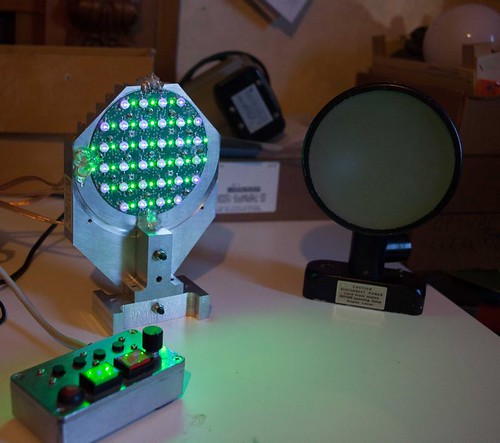

Some pictures of the head:
On the right, the light source of the Durst139, on the left my home made light source
On the bottom left, the remote control which is connected to the driver.
The LED head is on and we can easily see the network of green and UV/blue led.
My DIY B&W proportional LED head for my Durst 139/138 enlarger by stormpetrel_geek_mode, on Flickr

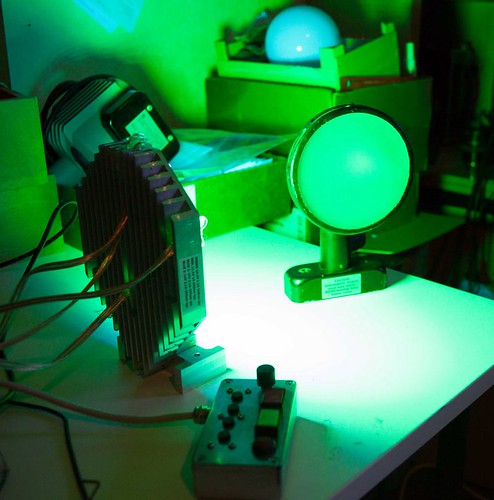

At full power!
It is VERY bright indeed. The heat think and the LEDs remains at room temperature. This is very impressive as I expected more heat generated by the LED.
It might be another story once in the enlarger head box, but this enlarger came with an air duct and a fan to cool down the krypton head light of the durst 139, so it will be very easy to evacuate the heat if necessary.

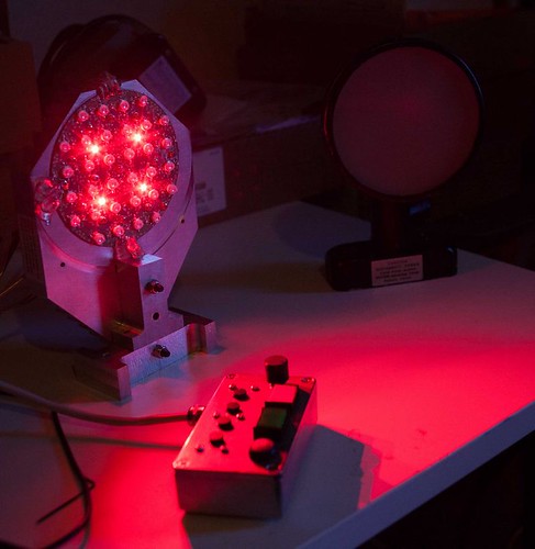

The red channel:
