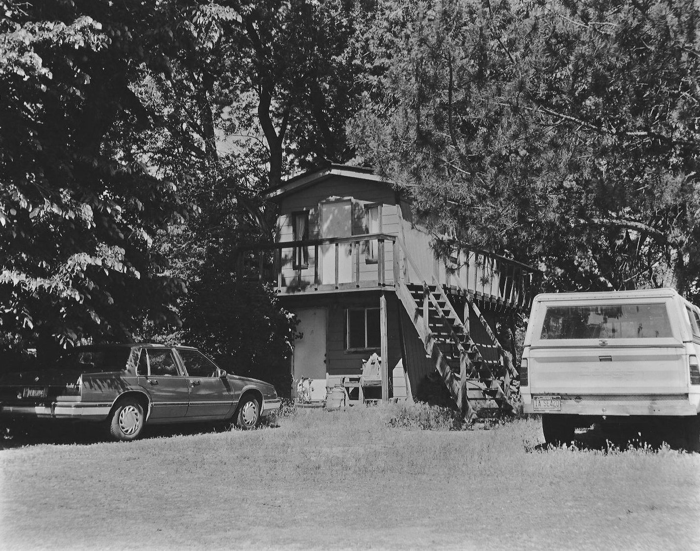

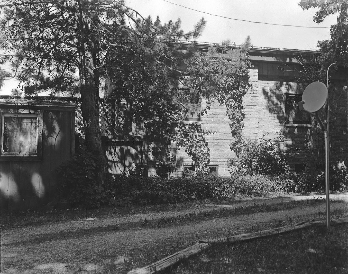

I recently resumed experimenting with homebrew developers after a long period of not doing anything in photography. I've read about Jim Galli's diluted Rodinal with added restrainer developer and viewed some of the linked images, and they're impressive.
But I wanted to see what I could come up with from my stock of dry raw chems, and I don't have any Rodinal on hand. Metol and sodium sulfite were picked because D-23 has a reputation for not blowing out highlights and not producing contrasty negatives. Instead of mixing a batch of D-23 and diluting it, the ingredients were mixed at tray dilution and different concentrations of ingredients and development times were tried.
I figured, if D-23 has fairly low activity with a high concentration of sodium sulfite, it might have somewhat lower activity if just enough sulfite was added to prevent oxidation of the metol during the processing session. A low concentration of metol might help with the very contrasty litho films.
What I'm using now is:
1000 ml water
A pinch of sodium sulfite to prevent oxidation of the metol
2 grams metol
10 grams sodium sulfite
Development time is about two and a half minutes at 70 deg F.
I started shooting the Arista Ortho Litho film at about ISO 2, but wasn't getting any shadow detail. So exposures were gradually increased and development shortened a bit. What's that old saying, "Expose for the shadows, develop for the highlights"?
I ended up with an exposure of 6 seconds at f32 in slightly hazy sun, resulting in an ISO of about 0.7 or so. Some of the negs have decent shadow detail.
Uneven development of negatives with edges darker than the center was a problem when the negatives were being developed in 8X10 trays. I tried different agitation methods including sliding the film out and back into the developer, but the dark edges persisted. Then tried larger trays, food storage containers from the big box store. This helped, but not completely.
Finally, I went for total overkill and bought a 16X20 tray for development. I had to mix two liters of developer to cover the tray bottom.
Upside - Uneven development all gone! A gentle agitation is all that's needed to get the 8X10 negative sliding around in the tray, from end to end and side to side. Easy as pie.
Downside - Uses lots of chemistry. But this isn't really so bad, because when litho films are developed for continuous tones, the developers are usually very dilute.
Equipment: Seneca Improved View, 8X10. The first image was shot with a beater 12" Dagor in an Ilex #4 shutter. Exposure was 6 seconds at f32 in slightly hazy sun. Film was an old batch of Arista Ortho Litho film bought in 2001. Contact printed on Ilford MG IV FB paper, scan of print.
The second image was shot with the same camera and a recently acquired Turner-Reich triple in 12"/19.7"/25" f7.0. Exposure was 8 seconds at f32. Film was a more recent batch of Arista APHS only about 2 years old. Little shadow detail, as the shadows were darker than in the first scene. Negative scan on a flatbed scanner. The scanned image is contrastier than I think a print will be.
This will be a lot of fun, but I don't think I'll ever get the same tonality as a film designed for continuous tone in-camera negatives. The litho film is just designed for completely different work.

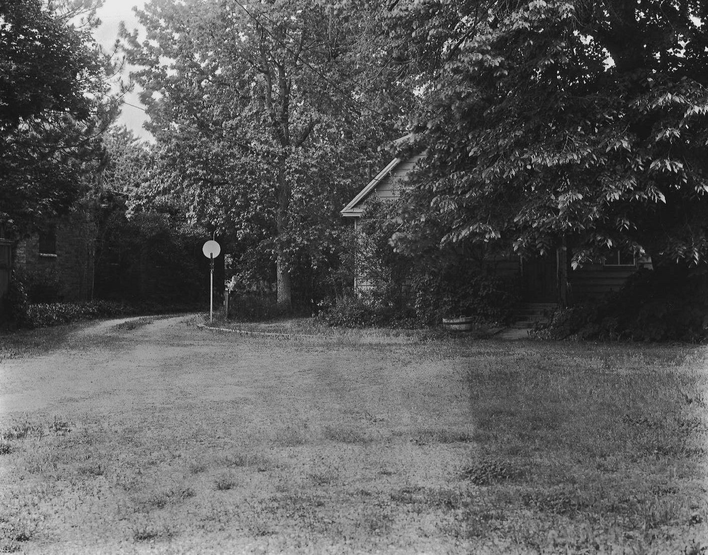

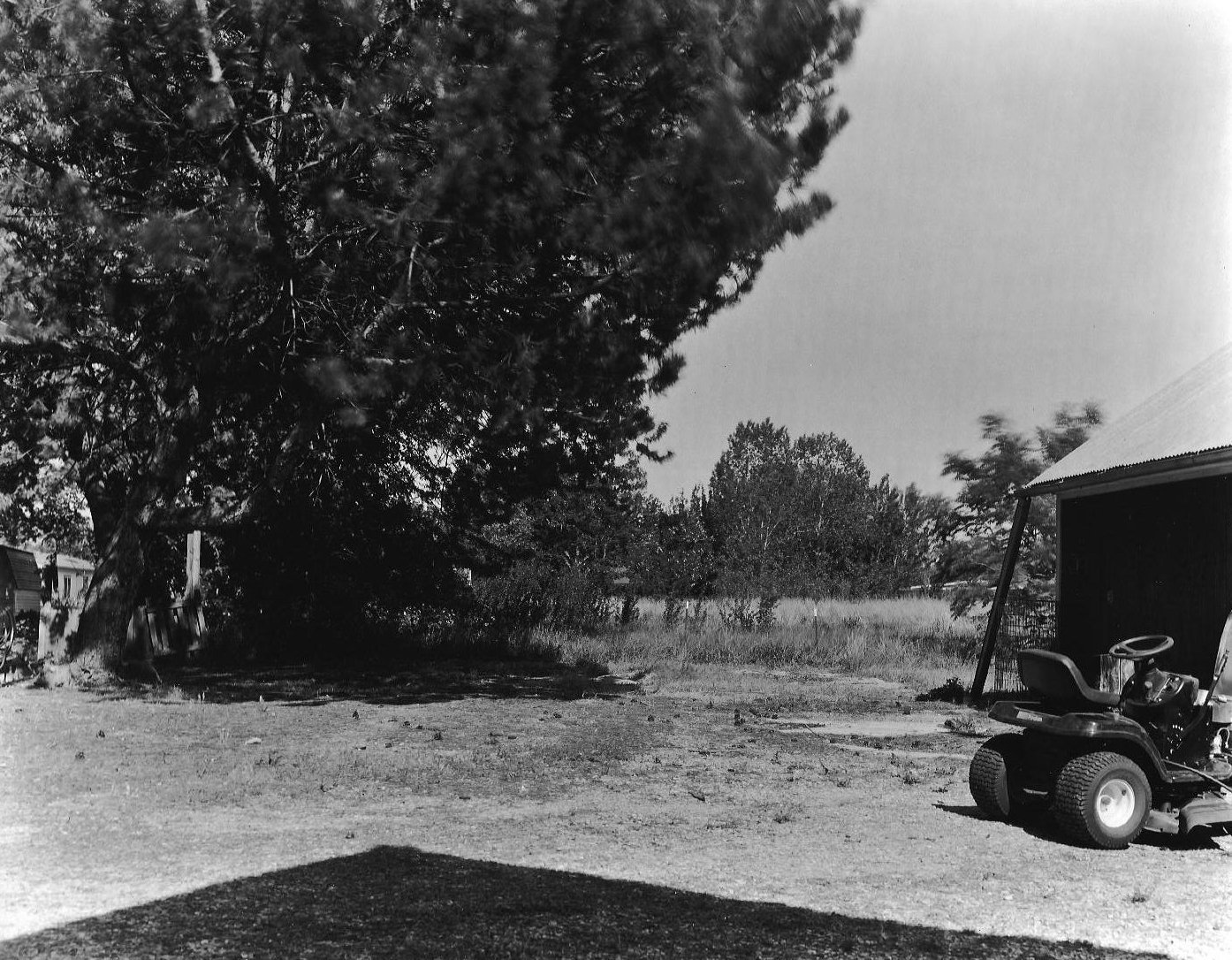

Some New Exposures
Thanks for the advice and info. I posted this also at the LF forum, and Andrew O'Neill suggested pre-exposure to help improve shadow detail. He does this in the camera, metering and making zone system calculations and then pre-exposing through a piece of translucent white acrylic plastic. The zone system calculations are what left desertrat behind!
Another user on a different thread pre-exposes in the darkroom with his safelight. This concept was easier to understand. I used my 6X6 color enlarger for a light source. Yellow + Magenta = Red, which Ortho film is blind to. I figured if I used less than max filtration with these colors, a little white light would get through, just enough to give manageable exposure times. After some experimentation, I arrived at 100Y + 100M with the 80mm lens aperture set at f16 for 10 seconds. This produced just a little density in test clips of film, just enough to get past the exposure threshold.
Then I tried longer exposures in the camera to see if a little more shadow density could be obtained. After pre-exposing the first sheet of film under the enlarger, I took the film holder outside to the camera waiting just inside the garage door, only to discover the sky had become overcast. Determined to make an exposure anyway, I shot the driveway scene for 45 seconds at f32, equivalent to about 11 seconds under sunny 16 conditions.
The first image has a sudden change in density in the foreground in the lower right hand corner. This was a developing oops on my part. The negative didn't get submerged completely in the developer, and I just kept agitating, figuring the developer would wash over it pretty quickly. That didn't happen, so I pushed the negative down into the developer but the damage had already been done. Development was for 3 minutes, and the negative was almost too contrasty to print. Contact printed on Ilford MGIV FB under max yellow filtration, using the enlarger as a light source. 2-1/2 minutes would have yielded better negative. But I got some detail in the deep shadows, dagnabbit!
The second image was shot in sunny 16 conditions, 10 seconds at f32. This would correspond to a film ISO of about 0.4. The lens for this shot was a brass 8X10 Rapid Rectilinear in a brass Wollensak shutter. The center of the image is fairly sharp, but the edges are quite soft. Developed for 2-1/2 minutes being careful not to repeat the mistake from the previous negative. Split grade print on the same paper. Most of the exposure under full yellow filtration, with just a tad of exposure under full magenta. Using the iris in an 80mm lens to help control the exposure, it was 10 seconds at 150Y at f11, followed by 10 seconds at 150M at f32.
This is as close to normal image tones as I've yet been able to get. The truck is painted white, and the tailgate was reflecting a lot of light, it was very bright. Yet the lettering embossed on the tailgate is faintly visible, and wasn't strongly visible in the original scene. There is some highlight detail, even with such a long exposure. The shaded portions of the workshop building are plainly visible, and a little detail is visible in the woodpile underneath and behind the stairs. The darker shaded areas, including under the vehicles, have little or no detail, but this is probably the best compromise I can get with this APHS film and homebrew developer.
This is a work in progress. I plan to try some of the other developers suggested, after I start getting more consistent results with what I have now.

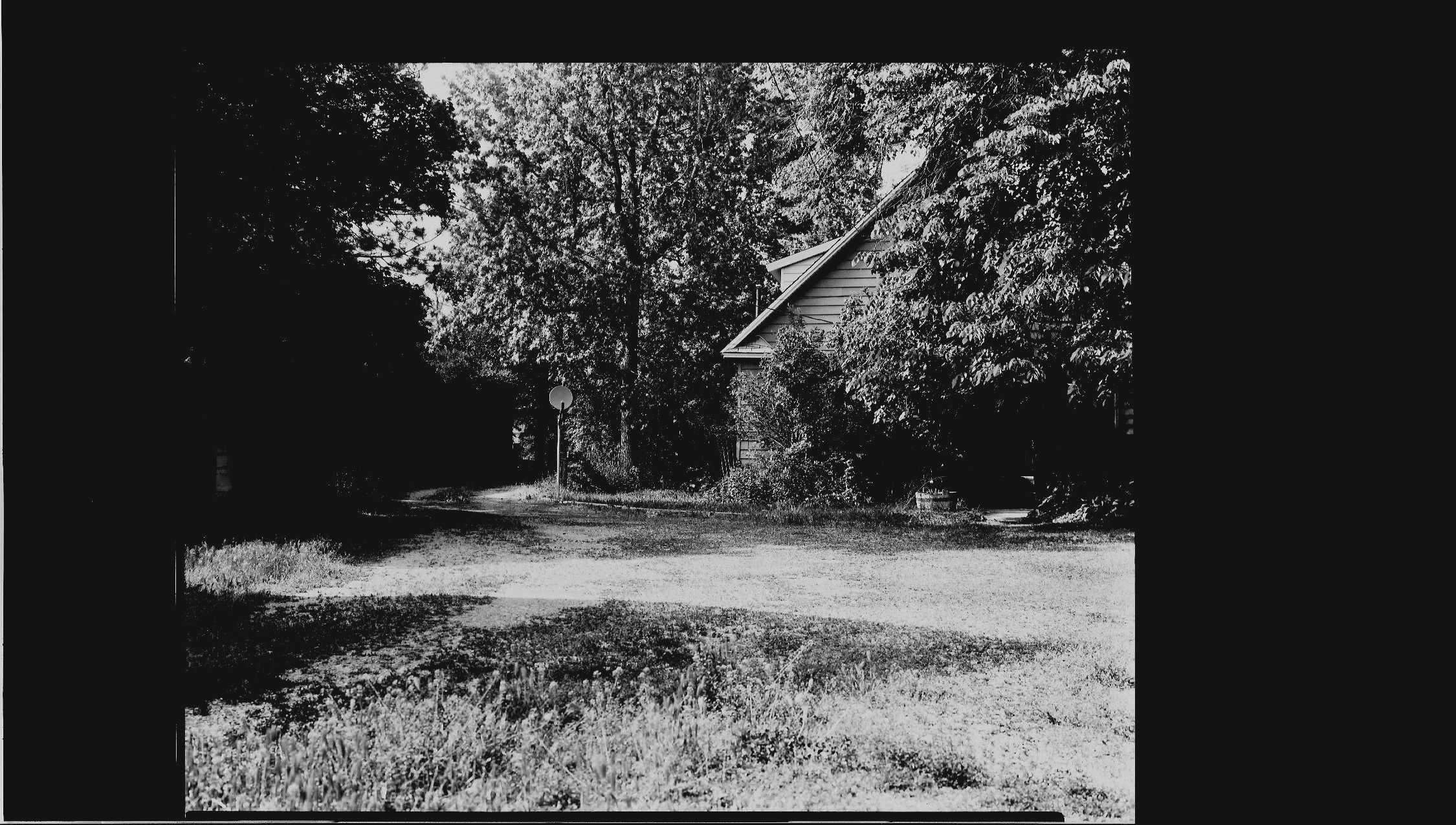

More Dilute Developer
I followed dancqu's advice on dilute metol developers and diluted my orginial formula about 1:3
2 liters water
pinch sodium sulfite
1 gram metol
5 grams sodium sulfite
This was used to develop an APHS negative that was pre-exposed under the enlarger and then exposed in the camera for 10 seconds at f22, for an E.I. of roughly 0.2. I went with a longer exposure because a lot of the scene was in the shade.
Development was by inspection, and went a lot slower. After 6 minutes, it looked like I had roughly what I had been getting in just over 2 minutes with the first formula.
The negative was a little too contrasty to print with grade 2 filtration, so the filtration was adjusted to an even split between 1 and 1-1/2, or 58Y + 16M. I have no doubt that 4-1/2 minutes development for the negative would have resulted in a negative that might have been a little flat for grade 2 filtration. Still using Ilford MGIV FB glossy paper and the color enlarger for a contact printing light source.
Equipment: 8X10 Seneca Improved View and 12" uncoated Dagor in Betax #4.
