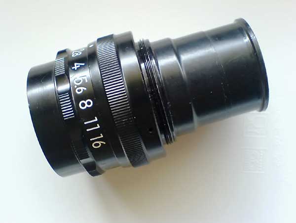

Another enhancement I've added to this is to attach a black kodak 35mm film canister to it with the bottom cut out. When you are looking through the reversed lens measure the approximate distance from the ground glass for focus. Then make a tube that from the canister and put it on with some kind of tape. That way you are focussing through a dark tunnel. I can even adjust fine focus in most situations without a dark cloth. And I much prefer this improvised loupe to my other "real" loupe for focussing.

I might mention that I use an enlarger lens, not an SLR lens. Compact, as sharp as any loupe you can buy and they are giving them away free on EBAy. The kodak canister seems just the right size and slides into my El-Nikkor 50/2.8 and stays on with a little electrician's black tape. Mine even has a little spacer at the other end so there isn't any gap between your eye and the lens for light to get through.
-Anupam
-Anupam
DUH!
Why did I never think of that?
Actually I DO have some old enlarger lenses I use as loupes -- but never (so far) on LF. Duh, duh, duh...
