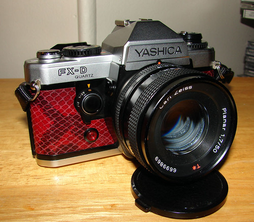

Last year, I re-covered a Yashica FX-D with this:

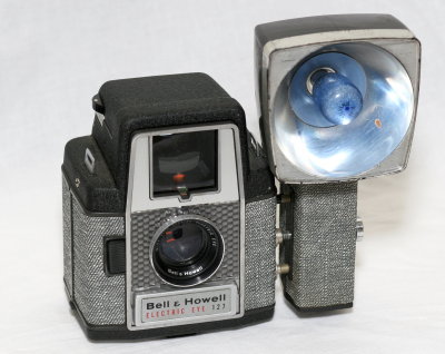

Hey, my Bell & Howell EE127 is covered in a denim-like twill and it came that way from the factory. It even has a matching case.
