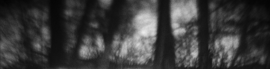

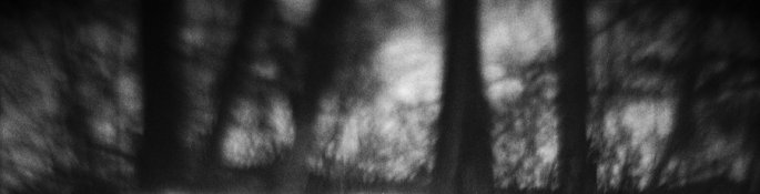

I've gotten swirlies by fitting a lens element from a junked 80's Canon P&S onto a Holga body (obviously with a smaller image circle than a Petz, and no TTL viewing, which is why these test images are unfocussed).
Examples: Element forward and reversed.
This one obviously has a thinner swirl band than yours does, but it's a very cheap and easy way to experiment. The element I used I believe was a piece that got switched in past a certain zoom setting; I can post a picture of it if you're interested.

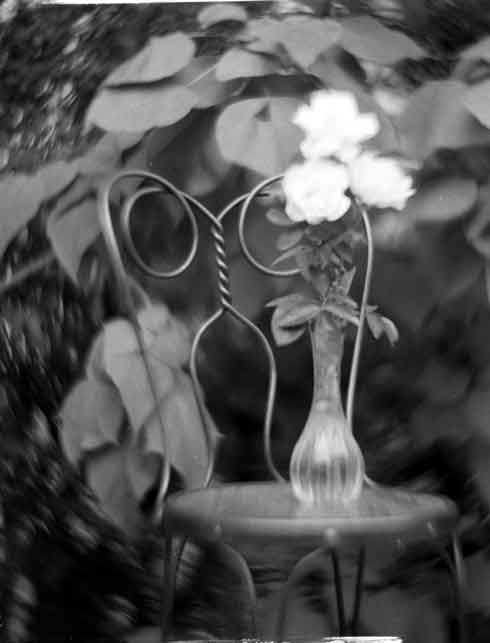

Jim, thanks for your continuing efforts of honing your abilities with your various Lens/tools. It seems that besides the subject matter variable, there may also be a distance and film size variable, i.e., subject to lens and size of the film for the particular swirl. If would appear that if a 5x7 lens is used on an 8x10 camera, there is more swirl than otherwise. Have you found this to be the case? Attached is an example of swirl whereas when the a subject shot was taken at a closer distance, I did not get the swirl. Thoughts?

G'mornin Jon. Actually I was just out playing again with that lens. Yes, too small a lens is an important aspect. The more important aspect is the relationship to the foliage that will be going out of focus to the subject. My wife has a bunch of black eyed susans growing on a white fence in the back yard. If I focus on the plane they live in, almost no swirls, but a lot of interesting barrel distortion in the corners. However if I roll the front forward to focus on a head that is 2 feet in front of that plane, the susan's go nuts. Kind of fun figuring this out. Also fun to see how much some folks really hate that look. I need some more victims. Let's see, I could offer kids some candy to come in my backyard..........ummm....maybe not.

An interesting effect. It looks like an extreme incidence of coma to me. I've seen similar to a much smaller degree in a couple of shots I made using the CV 40/1.4 Nokton (not LF I know). Here's the shot in question, you can see the coma in the top third of the frame.

The most pronounced "swirl" will appear in greater proportion to the extent that there is no plane at all in sharp focus.

From what (little) I've seen of swirly bokeh, it seems to happen most when a peripheral area of 'busy' high contrast (most often foliage or tree branches with backlighting) reacts with pronounced coma – which might explain why the garden shot had it and the portraits didn't.
