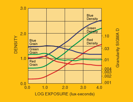

For colour negative film (and chromogenic B&W negative film - ie XP2 etc), which has lots of latitude, it is common practice to set the meter to one stop or more below the box speed. The graph below illustrates one of the main reasons. For colour negative film the graininess decreases with increasing exposure. This effect is most pronounced at the low end of the film's sensitivity.
You can see the effect in the graph below. Exposure increases from left to right.
Conventional (ie silver-image) B&W negative film behaves the other way round, so you may want to avoid overexposure - you may even want to sacrifice shadow detail in some cases.
