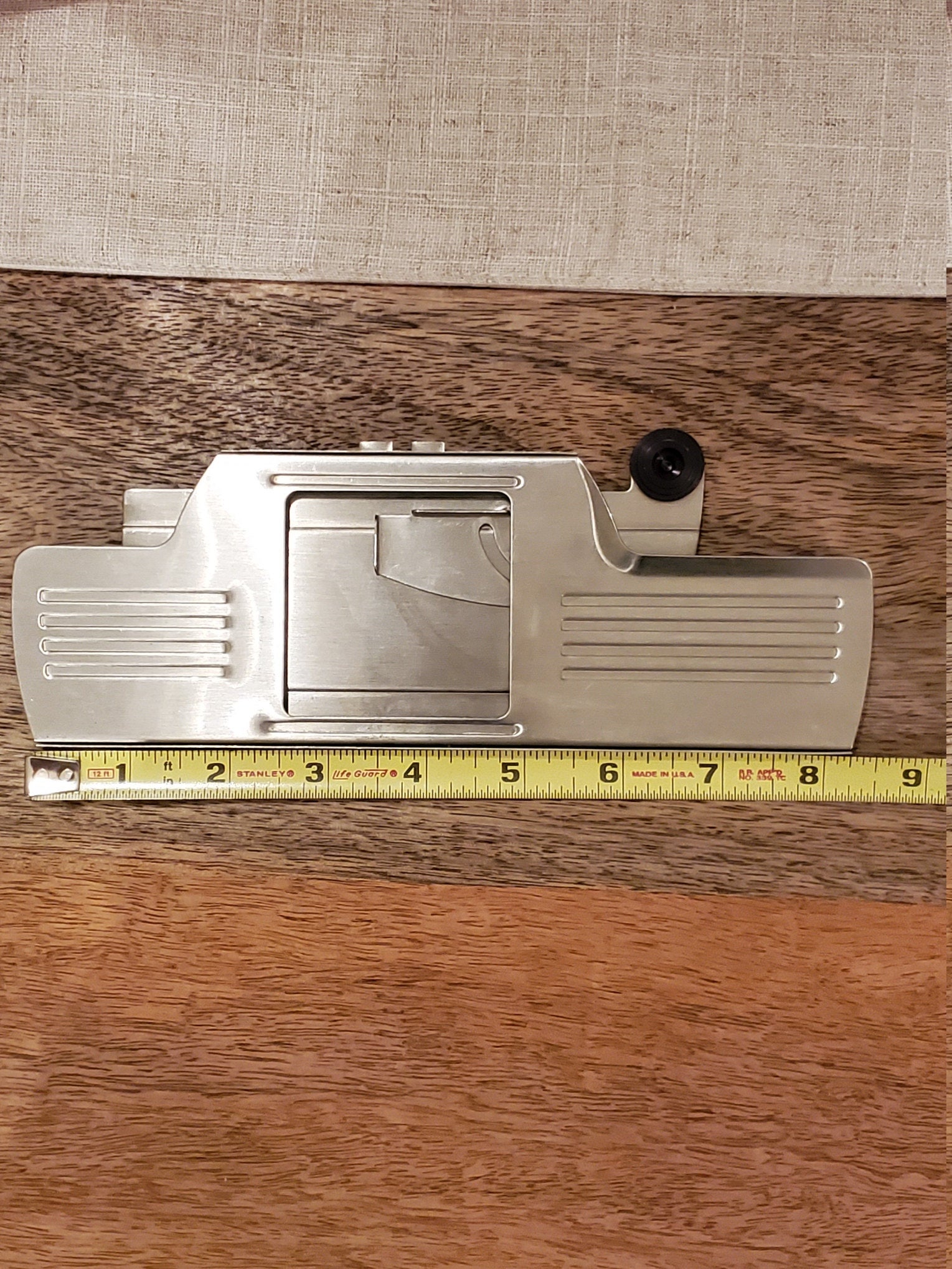

I am in the market for a medium format projector. Specifically a 6 X 6 projector for 120 film slides. They are getting pretty pricey but I did find an older manual unit. The seller is unsure of the slide carrier compatibility. He sent me a photo of the larger slide carrier. I am hoping it is for 6 X 6 and not 127 film. Can anyone help me identify it for sure? Thanks.

I am not even sure what I see... but I am ignorant on most US projectors anway. But a larger image would likely be helpful even for the initiated.
I do not know of any type 127 projector. Over here we head some type 135 projector models that either could also illuminate a 4x4cm frame or could be upgraded respectively.

That picture is way too small to give any evidence of what it may be . Can the owner just measure the size of the slide area ? Peter

As far as 127 slides the ones from my Komaflex S projected very well in an ordinary 35mm or 135 projector. Kinderman, for one, made several projectors that would handle 6x6 slides, the one I have is TOTALLY manual. Each slide is loaded one at a time. I know that there are some really deluxe projectors from Hasselblad and I think Rolleiflex, with deluxe prices to match.

I can't tell whether that is a part of a slide projector or something designed to slice sandwich meat.:D
But the opening appears to be measured as about 2.25 inches, and there doesn't seem to be any meaningful space at the top for a slide frame/mount.
So I am going to guess that opening is where a standard 35mm/126/127 slide or super slide would go.
Medium format slides are found in mounts that are either 70mm x 70mm (2.75" x 2.75") or 85mm x 85mm (3.35" x 3.35").

Here is a larger photo.

Now I am sure that that is too small and isn't for medium format slides.

Opening appears to be just under 2.5" square, and 6cm is 2.36".
Wouldn't leave much room for a frame at the bottom-- but doing a quick search, it looks like 6x6 mounts don't have a lot of frame to them.
If it's not 6x6, what is it? 4x4cm would only be 1.58" on a side.

We are likely going to mix up image size and mount outer size.
Leaving smaller and larger sizes aside, there are these outer sizes:

But if the hole in the carrier was the size of the outer border, then the whole slide would fall out. That's the point of a slide mount-- to securely hold the negative in place while shining a light through it.
The "carrier" may actually be a "changer", and only be designed to move a slide into position, not hold it for projection.
Aren't mysteries fun :smile:?

My Dad used an Airquipt projector when I was little. There was a manual changer that looked something like this. I suspect it's for 2x2 inch standard slides. Need more info.
