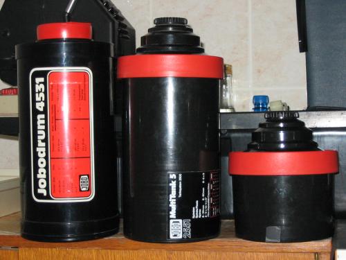

Finally, here's a quick shot that shows all 3 drums I have - from left to right:
1) 4531 PRINT drum (with "ordinary" lid)
2) 2551 (actually 2553, since it has the cog lid) FILM drum
3) 2523 small drum for 4x5 sheet film (with cog lid).
The 4531 print drum is obviously an older series, since the cog lid from the other two doesn't fit. There is probably some extension/adapter to make it use those lids.
Back to German ebay! :sad:

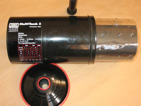

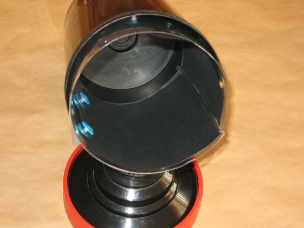

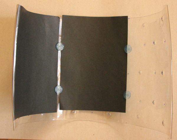

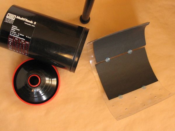

DIY solution, as always :smile:
Well, I couldn't wait to get a proper Jobo drum, so I followed the instructions from the link mentioned in my first mail (see LINK).
The only modification is that I made such an insert for a smaller FILM drum (Jobo 2551/2553), so that I can use it on my Jobo processor with lift.
The film adapter/sheath is done, now I just have to do a test run. It can accommodate only 3 5x7 sheets, bit it's better than nothing :smile:
The attached photos show how it looks like - no big deal, really. It's a piece of PET plastic sheet I got in a local "Home Depot" equivalent, probably used in construction. Later I realized I could have used a large PET (plastic) Coke bottle (2 litre) or something similar, as long as the bottle is regular cylindrical shape...
Anyway, using a hot air blower (the one used for stripping paint) I made relatively regularly spaced "dimples" to avoid film sticking to the plastic sheet, and to allow for anti-halation dye to be washed out in the prewash.
I added a few plastic rivets/studs to keep the sheets from overlapping. Anyway, it's all visilbe in the photos.
I'll let you know how the negs turned out. I don't expect much from the final shots, since today I exposed my first two 5x7 negs in a "new" camera (my "Chinadorff" :smile:), using a Packard shutter for the first time. So, the exposure was probably not quite right, but those two will do for a test of this developing solution. I just need to see if the development wil be even, without streaks, etc.
The photos are attached.
Denis

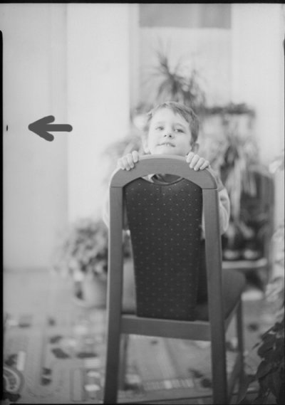

Curt,
The development in the assembly pictured above worked out fine - no streaks, development was even.
However, one of the plastic "holding pins" left a mark on the negative.
It can be taken care of by reducing the diameter of the head of that plastic pin, but I didn't do much about it, since a few days ago I got a "proper" Jobo print drum - 2840, which will enable me to develop 4 5x7 sheets at the same time.
My DIY solution above definitely works, but lets me soup only 3 sheets at a time, which is not very practical :smile:
Anyway, attached is a scan of the negative developed in it, with the arrow pointing to the only problem I found. Like I said, it could be solved by reducing the diameter of the plastic retaining pin, so it would not intrude into the image area.
Scan is rather poor - the negative was scanned as a positive, and then inverted...

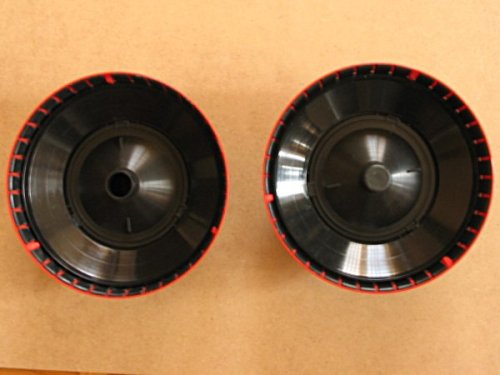

You can imagine my surprise when I got my 2840 print drums (two drums, but only one lid - the one with beaker), and when I realized that the smaller bottom part is actually a 2521 drum!!!
Yipee!!!
Anyway, I now have two lids with cogs for this series (25xx/28xx drums) - to be used on JOBO rotary processors, and one with a beaker (to be used manually).
I must admit that the more I see of Jobo stuff, the more it amazes me. Very ingenious stuff, and very exchangeable and configurable. Reminds me of Lego cubes :smile:
In short, in the past several months, I managed to add several more drums and bits (4x5 reels, for example) to my collection, so now I'm pretty much covered in all formats I use on my old Jobo CPE 2 processor (from 35mm to 5x7).
The more I use Jobo processor and drums, the more I like them :smile:

You don't need a center core to make the lid light-tight.
Just plug the bottom hole of the lid. Tested and tried. Works! :smile:
BTW, I can't claim to have discovered that myself - one of the cog lids I got with my 2523 drum for developing 4x5 sheets already had a plugged bottom hole (looks original, too!).
Later, when I got 2840 paper drums to process 5x7 sheets, I was wondering about getting (or making) extension center core, when I remembered that I don't need it at all! Just used the 2840 drum for 4 5x7 sheets yesterday (without the center core, with plugged bottom lid hole), and no light leaks!
One out of four 5x7 sheets got "glued" to the inner wall of the drum, and was not developed properly, though :sad: Three out of four came out OK - not really bad for the first time....
I'll have to be more careful next time, though, and watch carefully how the sheets go in. Either that, or make another DIY plastic "blanket" like the one I described earlier in this thread.
Attached (bad) photo shows unplugged (usual) lid on the left, and the one on the right has the hole plugged. No big deal, a simple DIY job really - just use appropriate diameter rubber plug, or whatever is at hand :smile:
