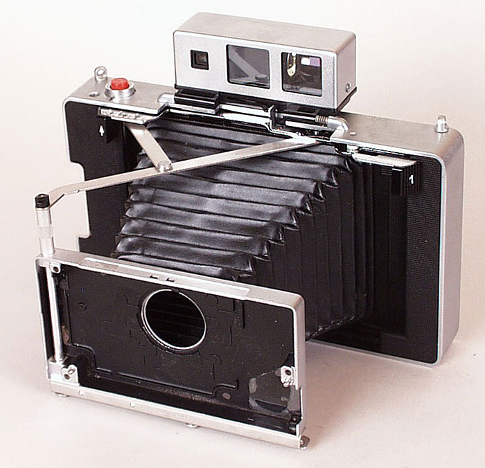

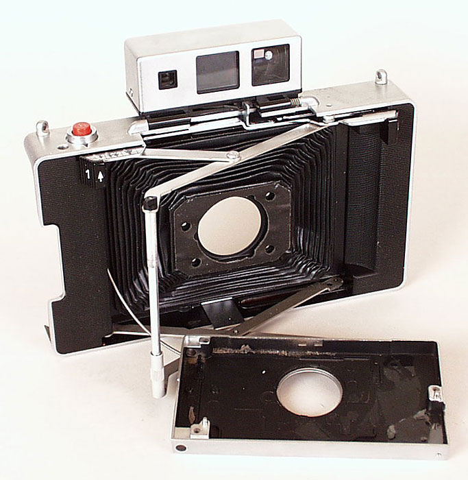

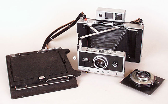

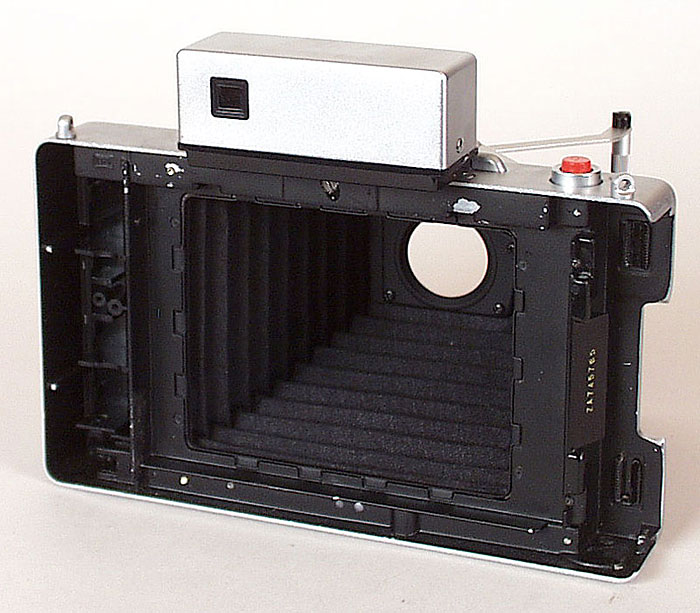

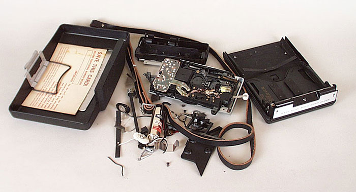

A thread on Rangefinder Forum got me going on this project but I thought there must be someone like minded here at APUG to share this insanity. I've admired the Littman 45 (an APUG sponsor), based on the Polaroid 110b, but my budget is too small for one. Actually, I don't have a budget. Dead Link Removed , and Dean at Razzeldog , have some nice conversions. Still too expensive but I figured I could do one myself. The Polaroid 110b is nice but it is a beast and more expensive than I want to spend ($100 if patient.) I decided to base my conversion on the Polaroid Automatic 250. Smaller, lighter, and way cheaper. I picked one up for $5. The first picture is the 250 with the Graflok back and Kodak Ektar 127/4.7 that will end up on it. I already had the back and lens. The 250 is quite a bit smaller than the 110b. The Graflok back is usually trimmed to fit on the back of the 110b. The ground glass holder in the Graflok back is about the height of the back of the 250. I want to keep the Graflock back untouched so it's going to extend a bit above and below the 250. The second picture has the basic tools needed to take it apart. I also used a box cutter to cut wires. There were lots of rivets and very few screws. The third picture is what is not going to be used.

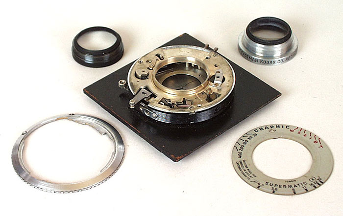

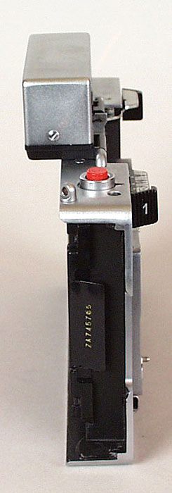

Here it is ready to be transformed into a 4x5 rangefinder camera. First I will need to get the lens a good CLA then mount it. Then I can find where infinity focus will be and go from there. I have a good idea of how I'm going to get there but mounting the lens will give me some specifics. The slow speed range on the Supermatic (X) shutter isn't working. The shutter hangs open. One option is to send the shutter out for a CLA and that needed the lens cells to come out. That was easy but the wooden lens board seems to have swollen from being in a damp storage. I will keep it in a warm dry place and see if it shrinks and I can get the board off. I thought I would pull off the front cover to see if there is anything obvious to account for the slow speeds not working. I looked and fiddled and then quickly put it all back together. I will be sending it off to Carol Miller . Carol takes 3 to 4 weeks so it will be another month or two before I can mount the lens on the Polaroid. In the meantime I will be filing away on the Polaroid lens board to provide clearence for the Ektar. The Kodak 127/4.7 Ektars are pretty good lenses and can be had for a reasonable amount. Its a 4 element Tessar that was popular on press cameras. They can be had, with some patience, for under $50 on eBay. This one was on my 3 1/4 x 4 1/4 Speed Graphic that I've had for a long time. The 4x5 Polaroid will be more useful than the Speed Graphic. Not as pretty , though.

I envision major trouble with the rangefinder -- the slope will be wrong for the longer lens (the original in these cameras is, IIRC, 114 mm). You'll have to either adjust the slope of the RF (not sure that's possible -- it's not designed to be adjusted, just replaced, even in warranty service), fabricate a linkage to proportionally transmit the strut movement that normally operates the RF, or alter the geometry of the struts to give the correct movement of the RF tab relative to the lens board.
You'll probably also wind up having to shorten the struts to get focus, if you don't mill some more off the back, but you'll know that when you get the lens mounted.
However, I'll be interested to see your progress, since this shouldn't require one of the glass-lens cameras (which are good enough in their own right to keep using in their original form), but ought to work with any pack-film Polaroid equipped with an RF and tripod socket (which means 2-3 models down the line, the ones with less versatility in exposure and cheaper lenses).
There are a lot of these 127 mm lenses out there, and even more 135 mm lenses -- if you can come up with a generic method of adjusting the RF operation in these Polaroids, you could start a pack-film renaissance... :smile:

Donald -- You're absolutely right about the 114mm lens. <cue head banging on wall> Why I assumed that if the 110s had a 127mm lens then the 250 would, I don't know. I double checked the Dead Link Removed: Lens: 114mm f/8.8 3-element glass. Having been there numerous times one would think I would have noticed. Apparently not. On to Plan B. I'm just going to have to wait and see what happens with the 127 installed. I'm not sure the rangefinder will be usable. I could always scale focus. Maybe put that Wollensak 90 on it...
