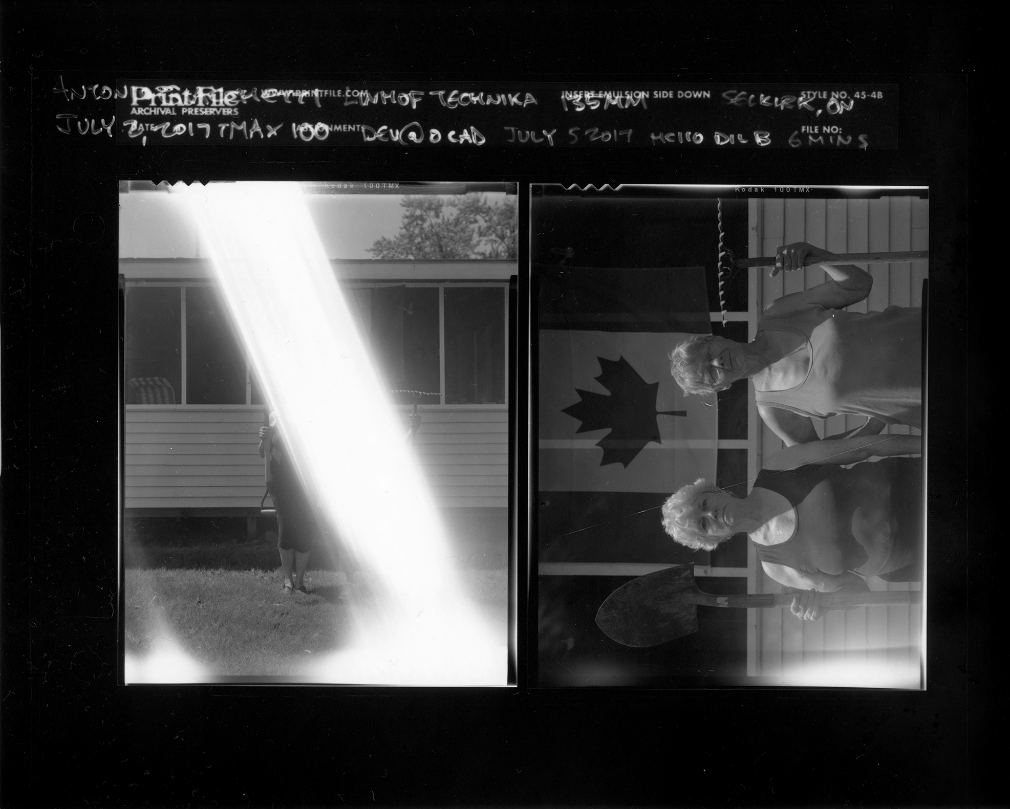

    Hey all! Long time browser, first time poster here.
    This summer, I rented a Linhof Technika from the university I work at and took it to my cottage this past weekend to give large format portraiture a try. During my undergrad I probably only made 8-10 exposures on 4x5 film and tended to gravitate more-so towards the medium format workflow.
    Picking up LF again was an incredibly pleasant and satisfying process and to my surprise I managed to make 12 exposures without a single mis-step. Once I was back home I unloaded my holders and transported all my film to a carrying box, unzipped my dark-bag, put away my holders, and for some reason, (blame it on distraction or stupidity) I opened the holding box and saw the bare flesh of my undeveloped film.
    Now I know there isn't much hope for that top sheet, but I've opened up camera backs before mid shoot and have been surprised to find nearly intact images only a few frames down the roll.
    I won't have a chance to develop the film for another 2 days but I guess I'm curious to know if anyone else can share some wisdom or solidarity to get me through the next 48 hours of frustration and kicking myself.
    Alternatively, if you've got any veteran tips to pass along to a beginner like myself, I would very much appreciate your know-how.
    I'm still looking forward to feeding this camera a good number a sheets this summer and I know mistakes are as much a part of the learning-process as anything!

    Joined:

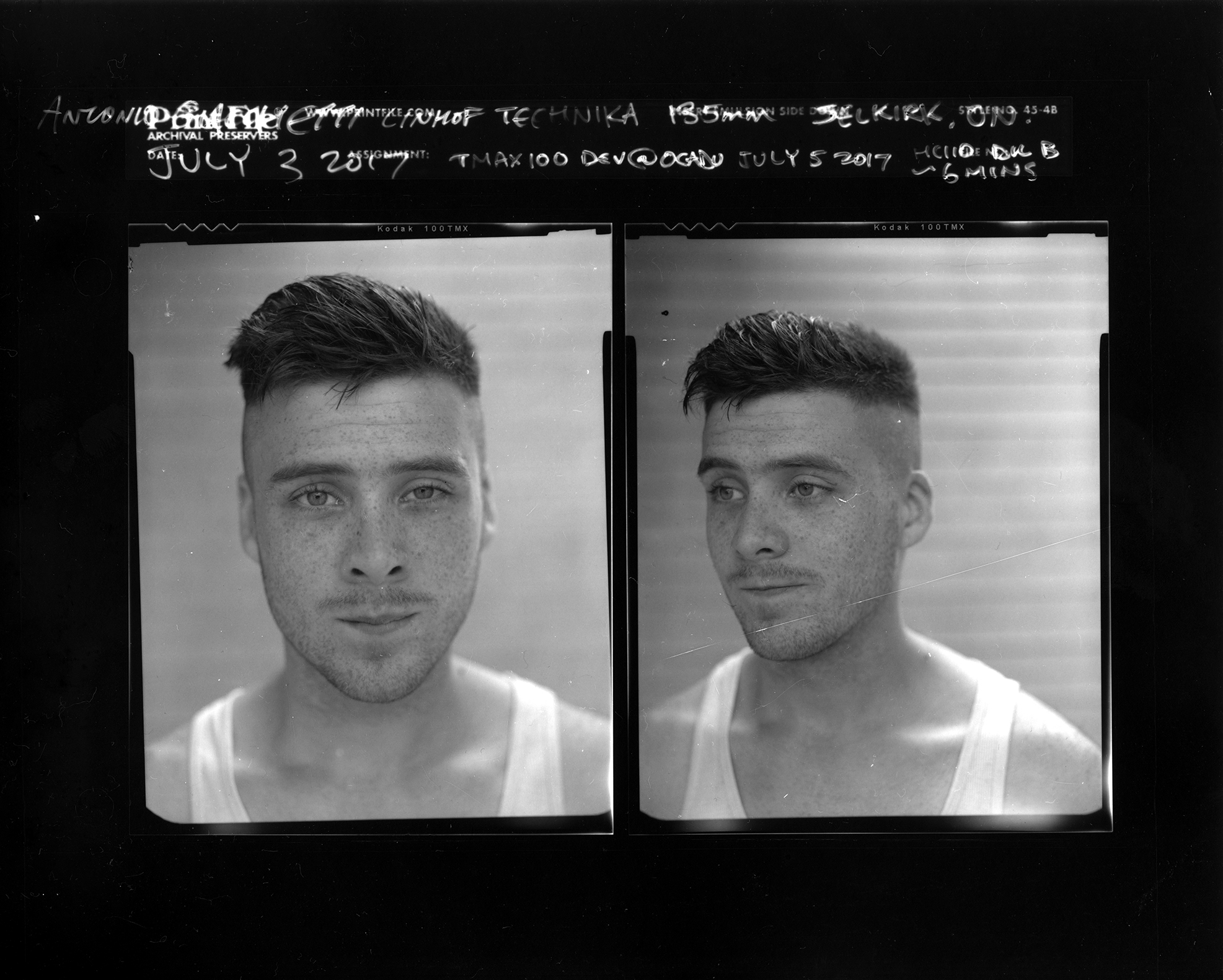

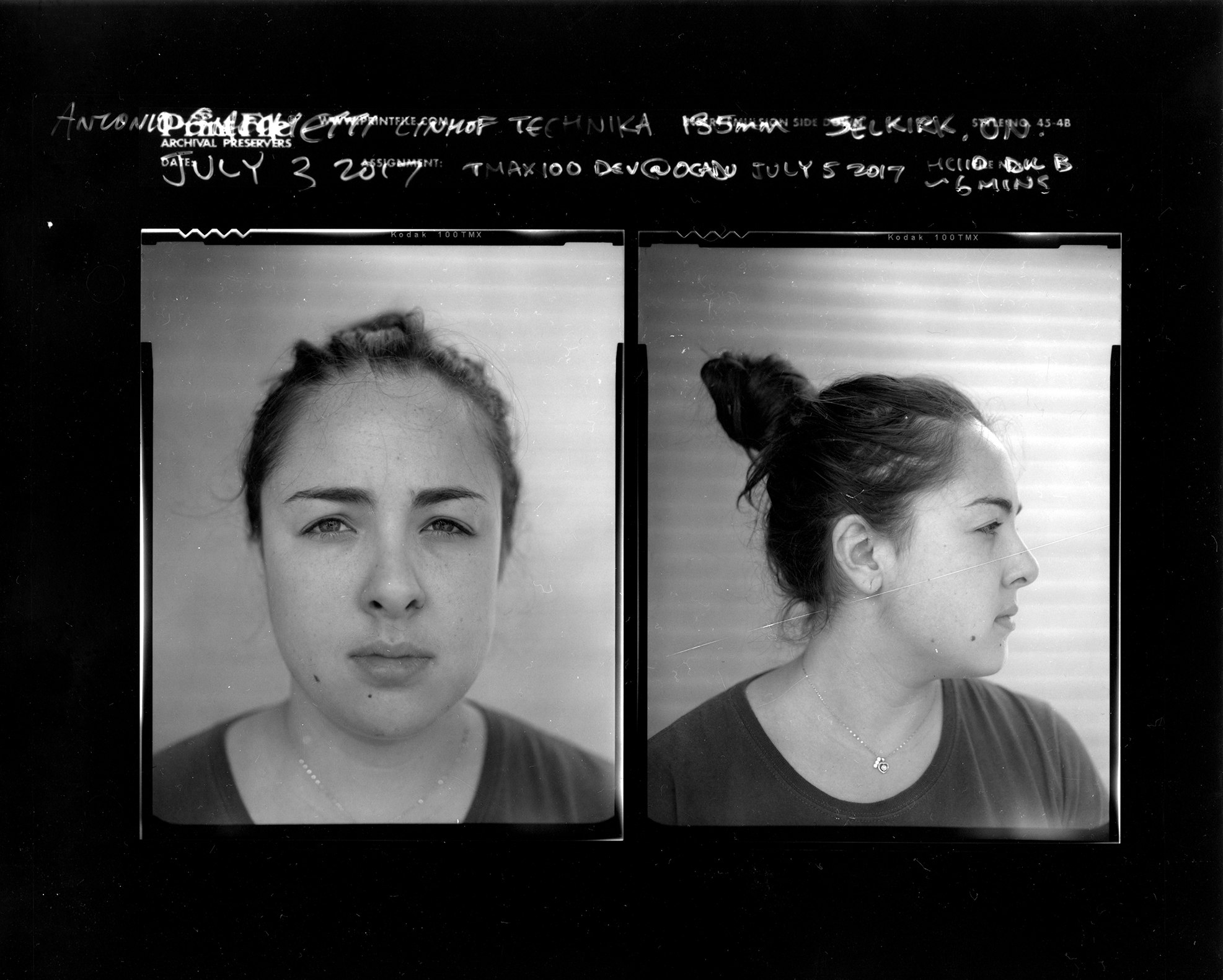

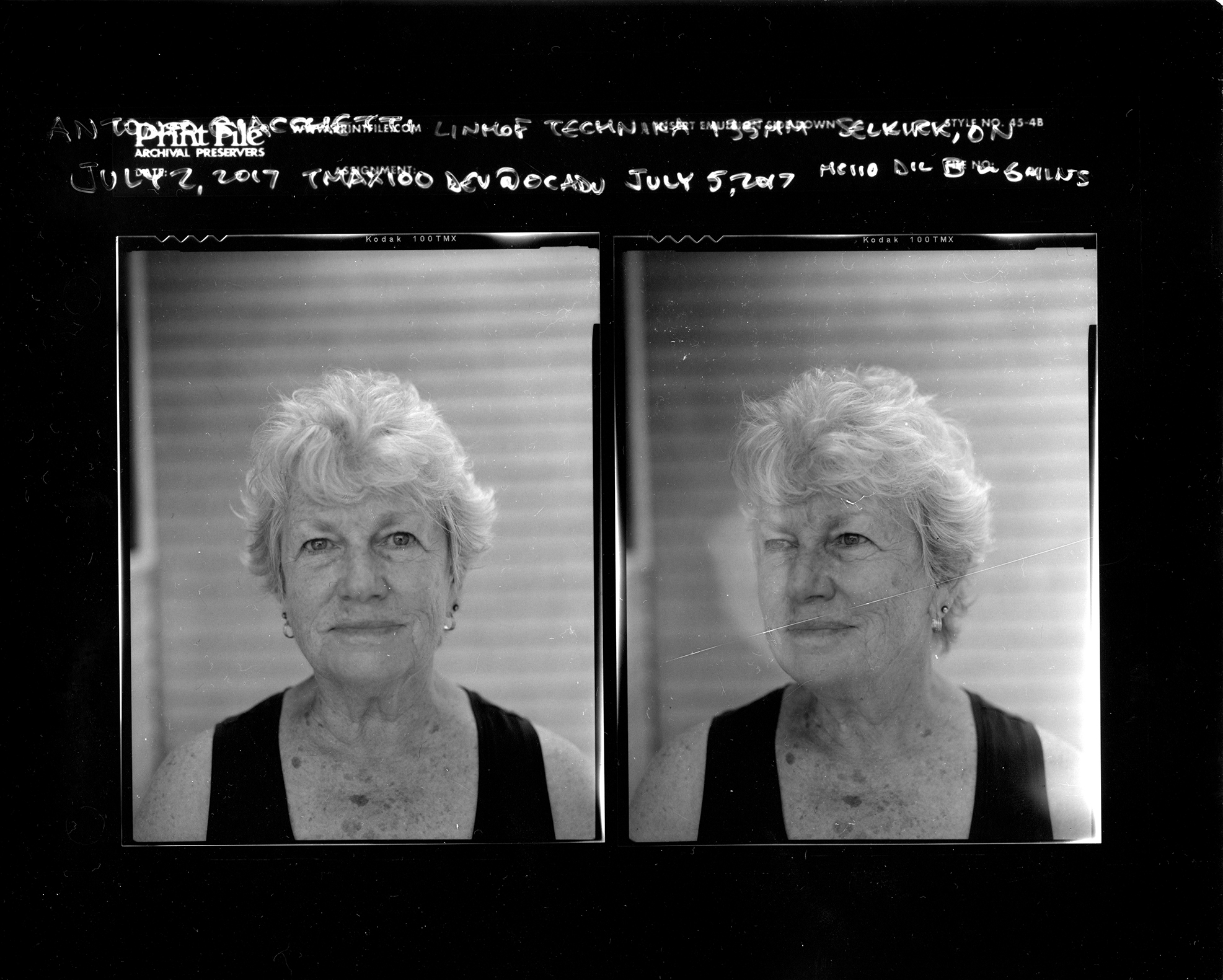

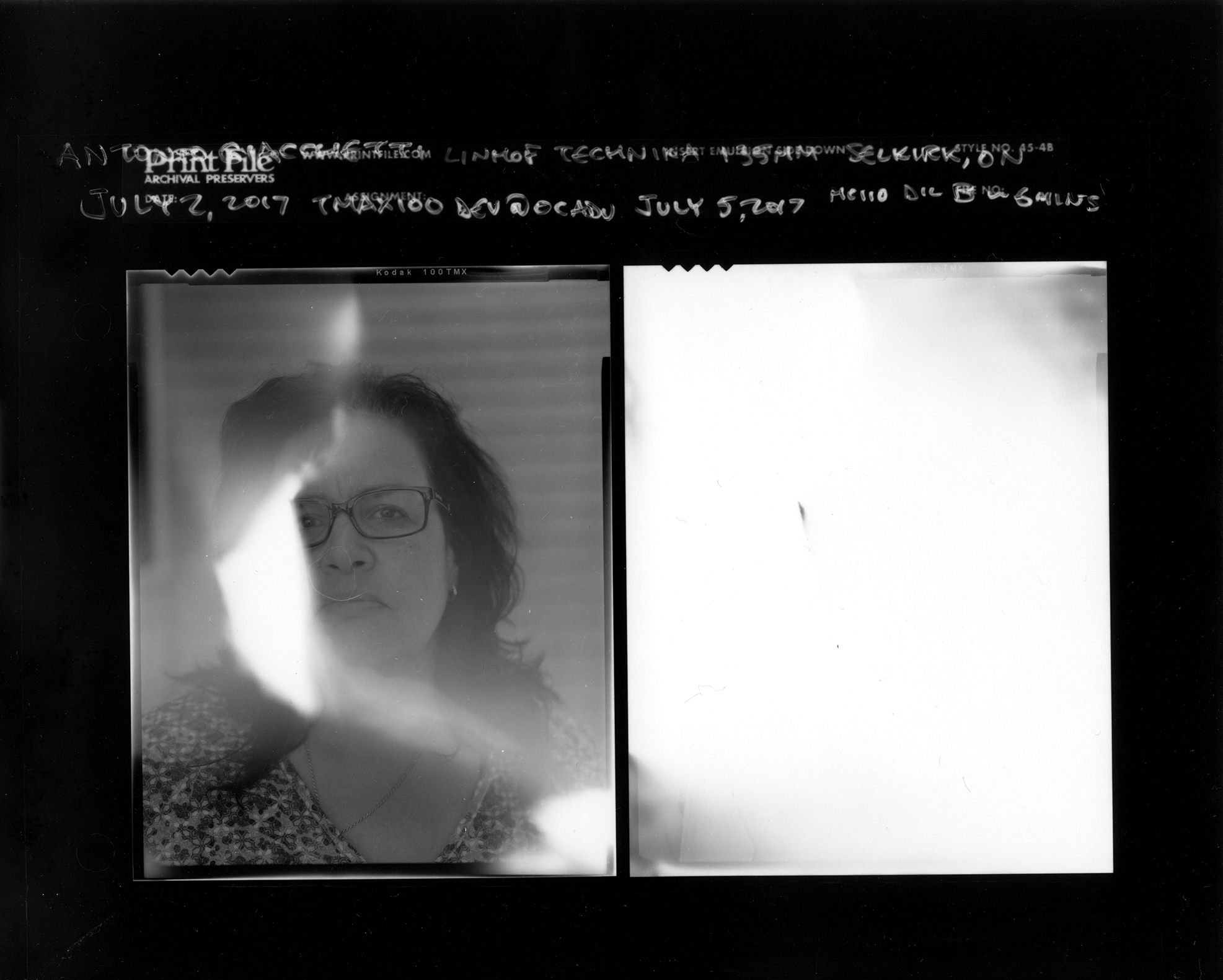

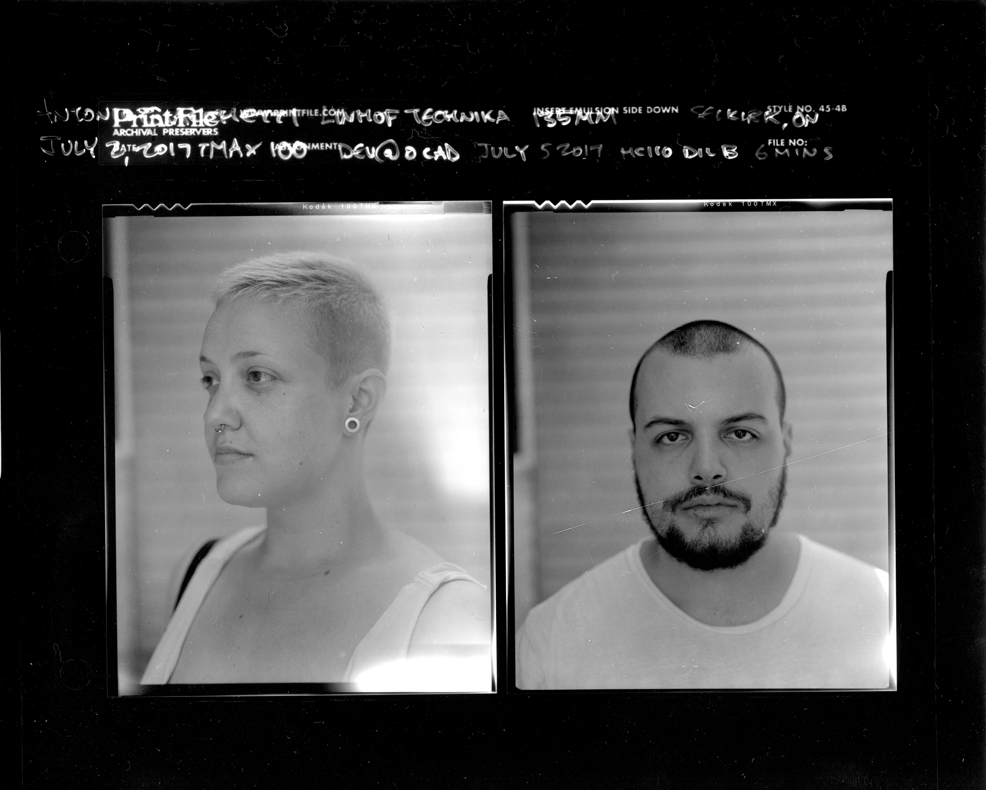

    Hey all, hate to revive an old thread but I realized I forgot to upload some same images from the film in question for those who were interested.
    The shots are ordered in the manner that I shot them but its clear the second contact sheet was from the film at the top of the stack after unloading.
    Some pretty clear fogging around the edges of almost all the frames but there are definitely some usable images here in my opinion.
    Please excuse the scratches and dust, the glass I use for contact prints is shared by students at a university and thus is well worn.
    Thanks again for all your tips and feedback, much appreciated!

    really nice images ( even the light struck ones ! )
    i love serendipitous image making when mistakes
    and a cold-sweat make great alchemy.
    i hope you have fun with your 4x5 ~!

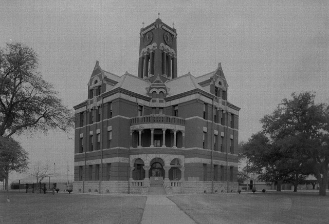

    Speaking of mistakes, this is what happens when you load a holder backwards and expose the non-emulsion side of the film. :smile:
    [​IMG]Lee County courthouse by Kenny Johnson, on Flickr
    I've never done that again. So far...
