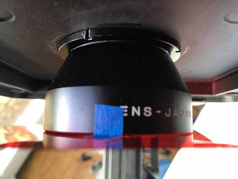

I have only used gelatin filters inside view cameras.
Do you know how the Pros hang gels. 1/2 X 1/4 inch piece of low tack masking tape bent in an L shape. One leg on the top of the rear lens element, one on the face of the gel near the edge so it lays perfectly flat against the lens barrel. They don't fade enough to notice because they are in light tight pouches most of the time. When they get damaged, you throw them away. See how fast you get rid of scratched glass. .003" in focus shift is nothing, the film isn't that flat.
As far as mat board, all the camera case dividers and half the studio was taped together mat board.
